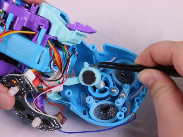

  12. Spin Master Hatchimal Draggle Nose Replacement, Nose Spring Replacement: crwdns2935265:012crwdnd2935265:01crwdnd2935265:02crwdne2935265:0 Spin Master Hatchimal Draggle Nose Replacement, Nose Spring Replacement: crwdns2935265:012crwdnd2935265:02crwdnd2935265:02crwdne2935265:0
    $3.99
    • Using the angled tweezers tool, disconnect the spring that is attached to the nose from the lever.
  13. Spin Master Hatchimal Draggle Nose Replacement: crwdns2935265:013crwdnd2935265:01crwdnd2935265:01crwdne2935265:0
    • Separate the body casing from the core and circuit board.
    • Don't damage the small wire connected from the top of the head to the circuit board.
  14. Spin Master Hatchimal Draggle Nose Replacement: crwdns2935265:014crwdnd2935265:01crwdnd2935265:01crwdne2935265:0
    • Remove a single 7mm Phillips #00 screw from the break.
    • Remove the spring.
