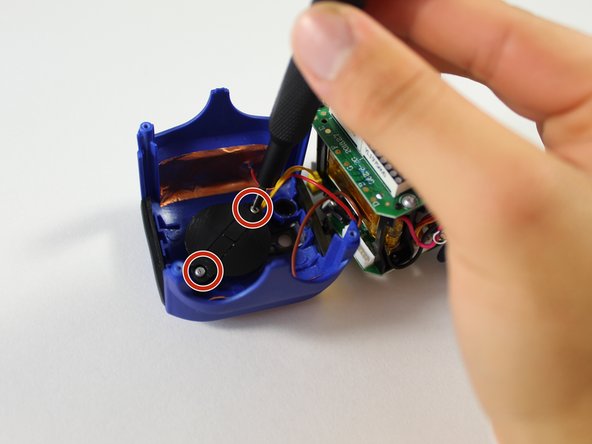

  6. Spin Master Boxer Robot Speaker Replacement, Robot Speaker: crwdns2935265:06crwdnd2935265:01crwdnd2935265:02crwdne2935265:0 Spin Master Boxer Robot Speaker Replacement, Robot Speaker: crwdns2935265:06crwdnd2935265:02crwdnd2935265:02crwdne2935265:0
    • Using a Phillips #00 screwdriver, unscrew the two 3mm screws connecting the black speaker cover to the top panel.
  7. Spin Master Boxer Robot Speaker Replacement: crwdns2935265:07crwdnd2935265:01crwdnd2935265:01crwdne2935265:0
    • Remove the speaker cover and you will be left looking at the speaker.
    • The speaker is soldered onto the top panel so additional measures must be taken to completely remove it. See How To Solder and Desolder Connections
