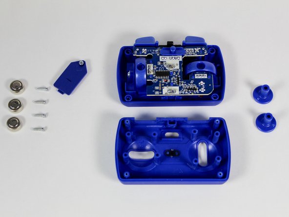

    • Lay the remote flat on your work space, with joysticks facing you.
  2. Spin Master Boxer Remote Trigger Buttons Replacement: crwdns2935265:02crwdnd2935265:01crwdnd2935265:01crwdne2935265:0
    • Remove both joysticks by gripping under circular knob and gently pulling towards you.
    • The joysticks should detach without much effort.
  3. Spin Master Boxer Remote Trigger Buttons Replacement: crwdns2935265:03crwdnd2935265:01crwdnd2935265:01crwdne2935265:0
    • Use the Phillips #00 Screwdriver to remove 4mm screw on the center battery panel.
    • Remove the batteries from the remote and set it to side.
    • Use the same screwdriver to remove all four 4mm screws on back panel.
  4. Spin Master Boxer Remote Trigger Buttons Replacement: crwdns2935265:04crwdnd2935265:01crwdnd2935265:02crwdne2935265:0 Spin Master Boxer Remote Trigger Buttons Replacement: crwdns2935265:04crwdnd2935265:02crwdnd2935265:02crwdne2935265:0
    • Insert the Jimmy in between the top panel and the bottom panel.
    • Gently use the Jimmy to separate both plastic panels from each other.
    • Pull the panels apart and set bottom piece on workbench.

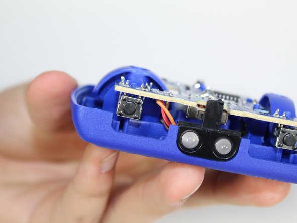

  5. Spin Master Boxer Remote Trigger Buttons Replacement: crwdns2935265:05crwdnd2935265:01crwdnd2935265:02crwdne2935265:0 Spin Master Boxer Remote Trigger Buttons Replacement: crwdns2935265:05crwdnd2935265:02crwdnd2935265:02crwdne2935265:0
    • Pinch the trigger between index finger and thumb, and lift up, away from circuit board.
    • Inspect the square button attached to circuit board to ensure functionality. If there is an issue with connection, a new circuit boards may be required.
