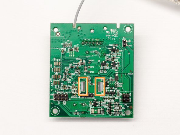

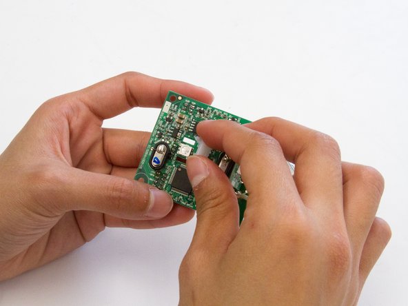

  6. Sphero Ollie LED Light Replacement, LED Light: crwdns2935265:06crwdnd2935265:01crwdnd2935265:03crwdne2935265:0 Sphero Ollie LED Light Replacement, LED Light: crwdns2935265:06crwdnd2935265:02crwdnd2935265:03crwdne2935265:0 Sphero Ollie LED Light Replacement, LED Light: crwdns2935265:06crwdnd2935265:03crwdnd2935265:03crwdne2935265:0
    • Locate the first LED light by looking for the white plastic cover on the motherboard.
    • Flip the motherboard over, and locate the tabs holding on the plastic LED cover.
    • Pinch the tabs to the LED cover on the bottom side of the motherboard to remove the cover from the top side of the motherboard.

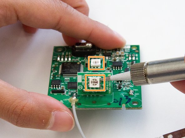

  7. Sphero Ollie LED Light Replacement: crwdns2935265:07crwdnd2935265:01crwdnd2935265:02crwdne2935265:0 Sphero Ollie LED Light Replacement: crwdns2935265:07crwdnd2935265:02crwdnd2935265:02crwdne2935265:0
    • Locate the second LED light by looking for the perpendicular section on the motherboard with a matching LED light soldered to it.
    • Carefully de-solder the adhered edges on both LED lights to remove from from the motherboard.
    • Use great care when using a soldering iron.
    • For more detailed information on how to solder, please see our How to Solder and Desolder Connections guide
