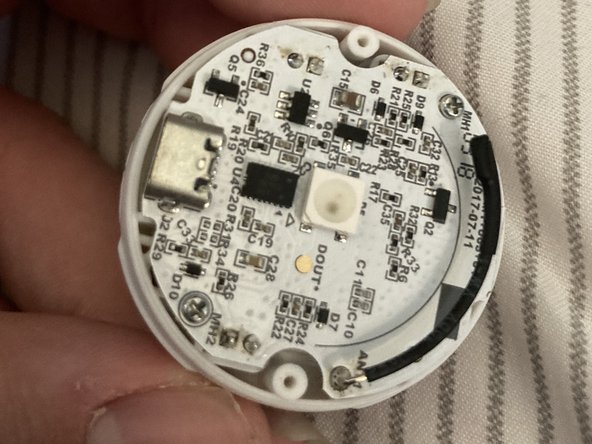

  3. Sphero Mini Battery Replacement, Remove the main board: crwdns2935265:03crwdnd2935265:01crwdnd2935265:02crwdne2935265:0 Sphero Mini Battery Replacement, Remove the main board: crwdns2935265:03crwdnd2935265:02crwdnd2935265:02crwdne2935265:0
    • The main board is also held in with two screws - go ahead and remove them.
    • You may need to slide the Bluetooth antenna’s sheath out of the way of one of the screws.
    • Again, keep track of your screws! These are a different length than the case screws.
    • Once the screws are out, pull the board directly up.
    • Everything is connected through some pin headers, so don’t worry about disconnecting any ribbon cables.
    • If one of the cables tries to come up with the mainboard, just pull it off and return it to its place.

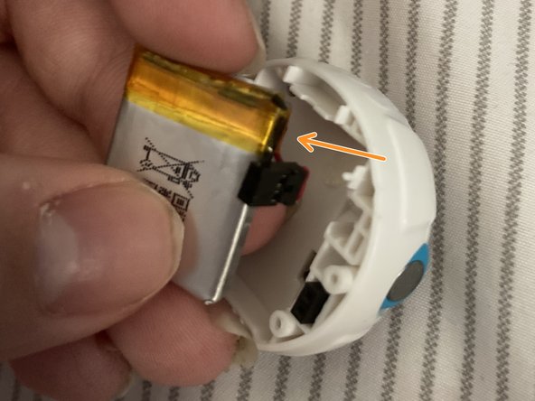

  4. Sphero Mini Battery Replacement, Remove the battery: crwdns2935265:04crwdnd2935265:01crwdnd2935265:02crwdne2935265:0 Sphero Mini Battery Replacement, Remove the battery: crwdns2935265:04crwdnd2935265:02crwdnd2935265:02crwdne2935265:0
    • There should be a small plastic sheet adhered to the top of the battery. Gently peel it off - we’re going to use it to lift the battery.
    • This might not be the best way to do it, but it seems to be the easiest for anyone not familiar with this type of stuff.
    • Use the plastic sheet to carefully pull upwards at the edge of the yellow tape on the battery. This should help release the small amount of adhesive.
    • Once the adhesive releases, gently pull the battery out of the way.
    • Then, you’ll need to get its connector out of the way. If it’s giving you trouble, try wiggling it a little to coax it out.

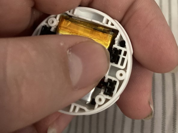

  5. Sphero Mini Battery Replacement, Insert the new battery: crwdns2935265:05crwdnd2935265:01crwdnd2935265:02crwdne2935265:0 Sphero Mini Battery Replacement, Insert the new battery: crwdns2935265:05crwdnd2935265:02crwdnd2935265:02crwdne2935265:0
    • If your battery has adhesive, peel off the protective layer.
    • Place the new battery into the slot.
    • Push the connector into the slot where the previous one was.
    • Make sure the polarities are in the same orientation as your old battery.
    • Stick that plastic sheet on top of the new battery.

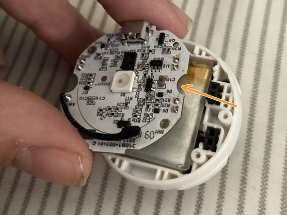

  6. Sphero Mini Battery Replacement, Reinstall the main board: crwdns2935265:06crwdnd2935265:01crwdnd2935265:02crwdne2935265:0 Sphero Mini Battery Replacement, Reinstall the main board: crwdns2935265:06crwdnd2935265:02crwdnd2935265:02crwdne2935265:0
    • Align the pins on the bottom of the board with the connectors below.
    • Push the board down securely.
    • Replace those 2 screws we took out earlier. (They’re the shorter pair in case you forgot).

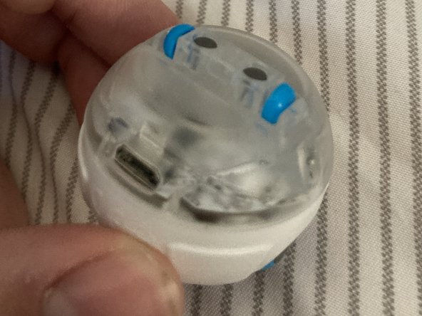

  7. Sphero Mini Battery Replacement, Put the top case back on: crwdns2935265:07crwdnd2935265:01crwdnd2935265:02crwdne2935265:0 Sphero Mini Battery Replacement, Put the top case back on: crwdns2935265:07crwdnd2935265:02crwdnd2935265:02crwdne2935265:0
    • This is mostly self-explanatory - just remember to line the hole up with the Micro USB port.
  8. Sphero Mini Battery Replacement, Put the shell back on: crwdns2935265:08crwdnd2935265:01crwdnd2935265:02crwdne2935265:0 Sphero Mini Battery Replacement, Put the shell back on: crwdns2935265:08crwdnd2935265:02crwdnd2935265:02crwdne2935265:0
    • Again, this is self-explanatory - just pop the main thingimajig between the shell and snap it shut.
