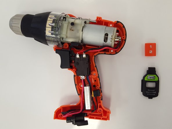

    • Use a phillips head screwdriver to unscrew the following 8 screws:
    • One 24mm Phillips screw
    • Six 16mm Phillips screws
    • One 9mm Phillips screw
    • Turn the drill to the other side and unscrew the marked screw using the same phillips head screwdriver. Place it with the other removed screws.
    • Keep all screws organized on a magnetic mat after removal.
  2. Speed Switch: crwdns2935265:02crwdnd2935265:01crwdnd2935265:03crwdne2935265:0 Speed Switch: crwdns2935265:02crwdnd2935265:02crwdnd2935265:03crwdne2935265:0 Speed Switch: crwdns2935265:02crwdnd2935265:03crwdnd2935265:03crwdne2935265:0
    • Carefully remove the plastic drill casing by pulling it apart.
    • When separating the drill casing, the black plastic speed switch covering will be removed from the drill automatically.
  3. Speed Switch: crwdns2935265:03crwdnd2935265:01crwdnd2935265:02crwdne2935265:0 Speed Switch: crwdns2935265:03crwdnd2935265:02crwdnd2935265:02crwdne2935265:0
    • Gently remove the orange plastic speed switch from the drill. It is located right above the motor.
