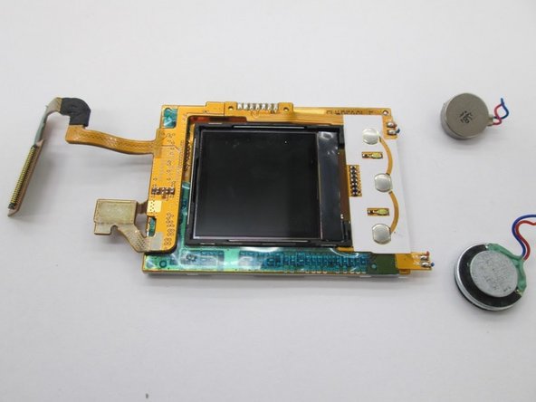

  12. Speakers: crwdns2935265:012crwdnd2935265:01crwdnd2935265:03crwdne2935265:0 Speakers: crwdns2935265:012crwdnd2935265:02crwdnd2935265:03crwdne2935265:0 Speakers: crwdns2935265:012crwdnd2935265:03crwdnd2935265:03crwdne2935265:0
    • Locate the two speakers. Using a spudger disconnect the speakers from the assembly.
    • Lift the screen assembly from the casing.
    • The screen assembly is completely removed to allow for easier access to the speaker connections when performing further repairs on the speakers.
  13. Speakers, Speakers: crwdns2935265:013crwdnd2935265:01crwdnd2935265:02crwdne2935265:0 Speakers, Speakers: crwdns2935265:013crwdnd2935265:02crwdnd2935265:02crwdne2935265:0
    • Use a pair of tweezers to disconnect the speaker wires from the circuit board. Note that the soldered connection must be broken for this to occur.
To reassemble your device, re-solder the speaker wires to the circuit board and follow the rest of the instructions in reverse order.
