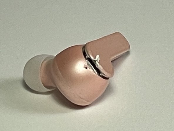

    • Remove the flat cover with a 1/16" punch tool by inserting it into the divot at the top of the earbud.
    • Be careful not to push too hard or upwards.
    • There is a lot of adhesive securing the cover, so using a mild heat will help loosen the adhesive.

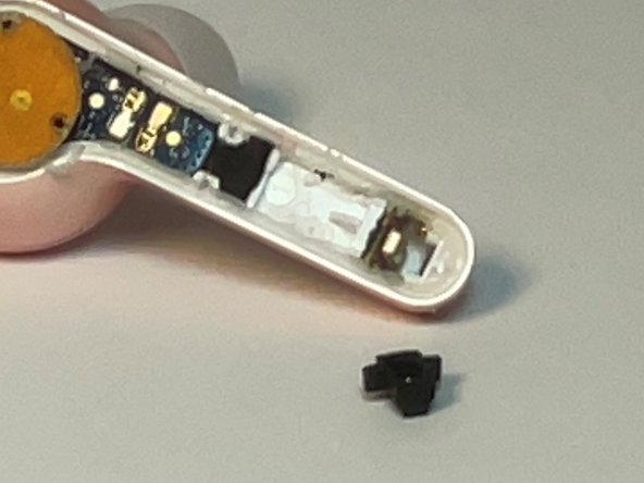

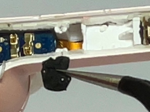

    • Remove the black rubber cross from the bottom of the earbud with angled tweezers.
    • Do not poke through the rubber.

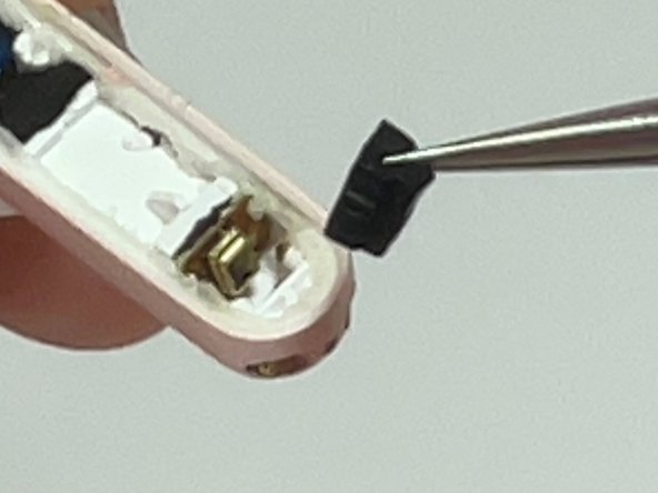

  4. Soundcore Liberty Air Charging Pins Replacement: crwdns2935265:04crwdnd2935265:01crwdnd2935265:03crwdne2935265:0 Soundcore Liberty Air Charging Pins Replacement: crwdns2935265:04crwdnd2935265:02crwdnd2935265:03crwdne2935265:0 Soundcore Liberty Air Charging Pins Replacement: crwdns2935265:04crwdnd2935265:03crwdnd2935265:03crwdne2935265:0

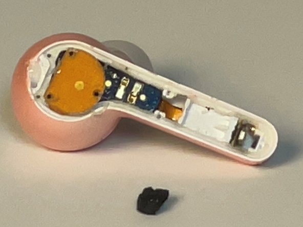

    • Remove the top rubber rectangle with angled tweezers.
  5. Soundcore Liberty Air Charging Pins Replacement: crwdns2935265:05crwdnd2935265:01crwdnd2935265:03crwdne2935265:0 Soundcore Liberty Air Charging Pins Replacement: crwdns2935265:05crwdnd2935265:02crwdnd2935265:03crwdne2935265:0 Soundcore Liberty Air Charging Pins Replacement: crwdns2935265:05crwdnd2935265:03crwdnd2935265:03crwdne2935265:0

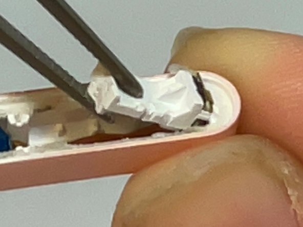

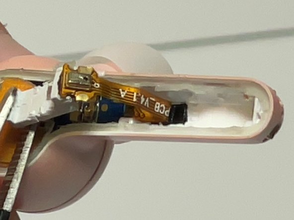

    • Remove the white block from the earbud with blunt tweezers.
  6. Soundcore Liberty Air Charging Pins Replacement: crwdns2935265:06crwdnd2935265:01crwdnd2935265:03crwdne2935265:0 Soundcore Liberty Air Charging Pins Replacement: crwdns2935265:06crwdnd2935265:02crwdnd2935265:03crwdne2935265:0 Soundcore Liberty Air Charging Pins Replacement: crwdns2935265:06crwdnd2935265:03crwdnd2935265:03crwdne2935265:0

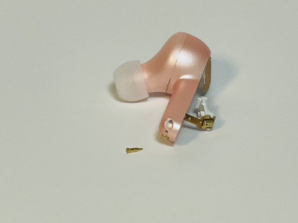

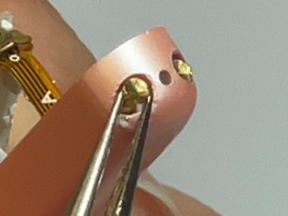

    • Push out charging pins with the 1/16" tool.
    • Pull out the rest of the charging pin with angled tweezers
  7. Soundcore Liberty Air Charging Pins Replacement: crwdns2935265:07crwdnd2935265:01crwdnd2935265:02crwdne2935265:0 Soundcore Liberty Air Charging Pins Replacement: crwdns2935265:07crwdnd2935265:02crwdnd2935265:02crwdne2935265:0
    • Replace charging pins with angled tweezers.
