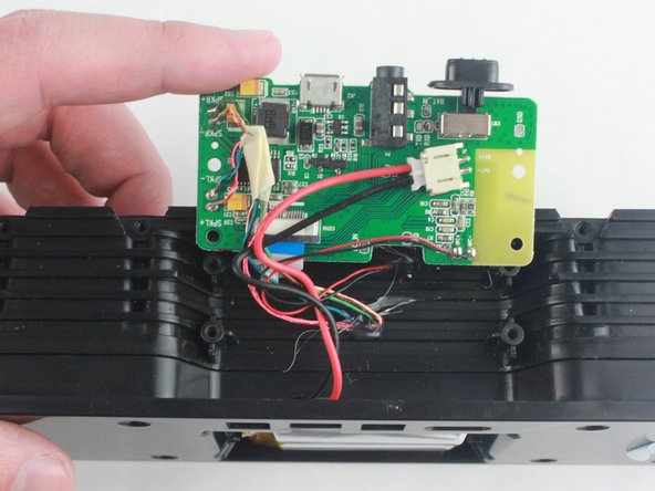

    • With the bottom plate removed now use the blue plastic opening tool to lift up the circuit board from the device.

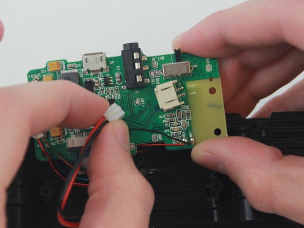

    • Disconnect the battery wires from the circuit board.
