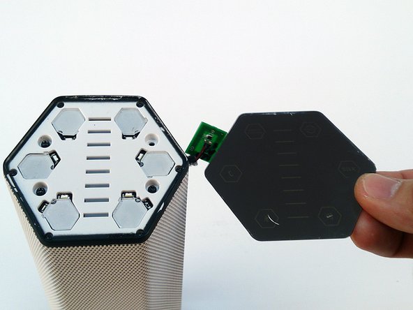

    • The AXX 200 is well put together. And by that, I mean the plastic housing on the back is held in place by adhesive. Lots and lots of adhesive.
    • Start by using opening picks to remove the adhesive holding the back casing. A hair dryer or heat gun would help.
    • Plastic opening tools are also brought into the picture to get past the sticky adhesive and to pry open the back casing.
    • A spudger with a longer tip would be more helpful – or a plastic ruler could work as well.

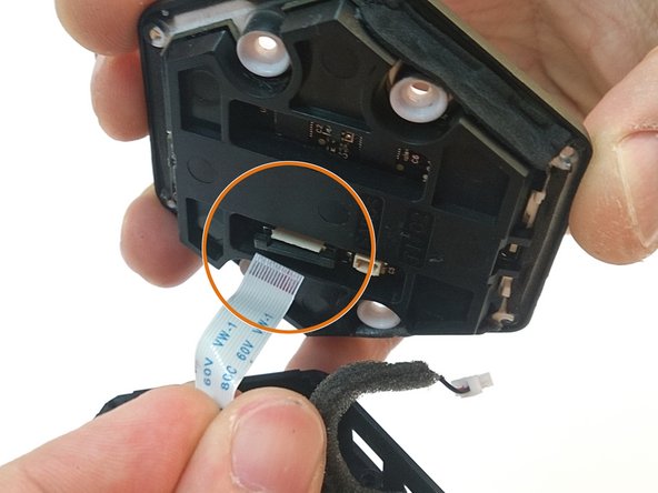

  3. Sound BlasterAxx AXX 200 Teardown, Detaching back housing: crwdns2935265:03crwdnd2935265:01crwdnd2935265:03crwdne2935265:0 Sound BlasterAxx AXX 200 Teardown, Detaching back housing: crwdns2935265:03crwdnd2935265:02crwdnd2935265:03crwdne2935265:0 Sound BlasterAxx AXX 200 Teardown, Detaching back housing: crwdns2935265:03crwdnd2935265:03crwdnd2935265:03crwdne2935265:0
    • After getting through the adhesive, lift the back casing open as pictured.
    • Warning: CAREFUL! A flex connector holds the buttons on the back casing to the unit, so don’t be too eager pulling the back casing away.
    • Disconnect the flex connector by simply pulling it downwards with a pair of flat-head tweezers
    • Then, remove the button PCB panel with a Phillips #0 screwdriver.

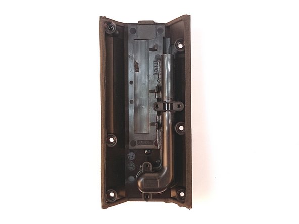

  4. Sound BlasterAxx AXX 200 Teardown, Opening the chamber: crwdns2935265:04crwdnd2935265:01crwdnd2935265:03crwdne2935265:0 Sound BlasterAxx AXX 200 Teardown, Opening the chamber: crwdns2935265:04crwdnd2935265:02crwdnd2935265:03crwdne2935265:0 Sound BlasterAxx AXX 200 Teardown, Opening the chamber: crwdns2935265:04crwdnd2935265:03crwdnd2935265:03crwdne2935265:0
    • Remove the audio chamber by unscrewing the 6 screws with a Phillips #2 screwdriver.
    • Warning: lift up the delicate NFC sensor with tweezers before opening the chamber. You will have to peel off any excess adhesive to reveal the screw holes.
    • It’s a sizeable audio chamber for such a small speaker. Upon opening it up, you will easily identify:
    • 5200 mAH lithium ion battery
    • Port tube for boosted bass
    • Drivers x 2
    • You’ll also notice that all the cables (and there are a lot of them) are shielded with foam to prevent rattling.

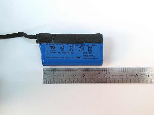

  5. Sound BlasterAxx AXX 200 Teardown, Battery and port tube: crwdns2935265:05crwdnd2935265:01crwdnd2935265:03crwdne2935265:0 Sound BlasterAxx AXX 200 Teardown, Battery and port tube: crwdns2935265:05crwdnd2935265:02crwdnd2935265:03crwdne2935265:0 Sound BlasterAxx AXX 200 Teardown, Battery and port tube: crwdns2935265:05crwdnd2935265:03crwdnd2935265:03crwdne2935265:0
    • Great Odin’s raven! That’s a big battery!
    • It’s a whopping 3.7V Li-ion battery with 5200mAh, and it’s used to power the device and charge your phone.
    • The built-in port tube enhances bass.
  6. Sound BlasterAxx AXX 200 Teardown: crwdns2935265:06crwdnd2935265:01crwdnd2935265:01crwdne2935265:0
    • There is a hidden PCB in end of the battery, check here for charging issues

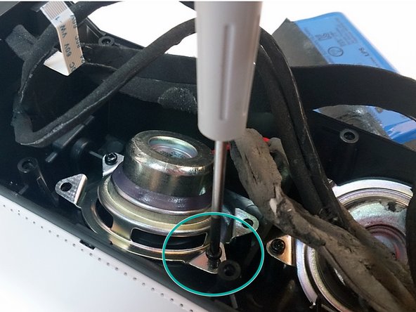

  7. Sound BlasterAxx AXX 200 Teardown, Taking out the drivers: crwdns2935265:07crwdnd2935265:01crwdnd2935265:03crwdne2935265:0 Sound BlasterAxx AXX 200 Teardown, Taking out the drivers: crwdns2935265:07crwdnd2935265:02crwdnd2935265:03crwdne2935265:0 Sound BlasterAxx AXX 200 Teardown, Taking out the drivers: crwdns2935265:07crwdnd2935265:03crwdnd2935265:03crwdne2935265:0
    • Using tweezers and screwdrivers, carefully remove the black tack (or adhesive putty) used to keep the cables in place at both ends of the chamber.
    • Sound Blaster really hasn’t stinged on the putty. There is a lot of it. It makes for an airtight enclosure, but the amount of putty really is quite overwhelming. Have I mentioned there’s a lot of putty? Oh okay, good.
    • Two microphones can be spotted at the top of the audio chamber, but there’s no way to access them from here.
    • Once the cables are loosened, remove the drivers with a Phillips screwdriver.
    • The unique positioning of the drivers allows for a wider sound spectrum. Both drivers measure about 1.6 inches (or 40 mm) each.

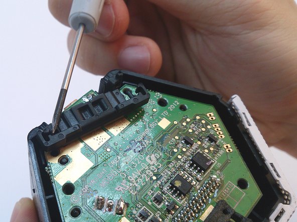

  9. Sound BlasterAxx AXX 200 Teardown, Removing PCB stack: crwdns2935265:09crwdnd2935265:01crwdnd2935265:03crwdne2935265:0 Sound BlasterAxx AXX 200 Teardown, Removing PCB stack: crwdns2935265:09crwdnd2935265:02crwdnd2935265:03crwdne2935265:0 Sound BlasterAxx AXX 200 Teardown, Removing PCB stack: crwdns2935265:09crwdnd2935265:03crwdnd2935265:03crwdne2935265:0
    • Use a flathead 3/32" screwdriver to carefully unhook and release the catch holding the PCB.
    • Be gentle so you don’t break the plastic catch.
    • The various ports at the bottom of the AXX 200 seem to be separated into different PCBs.
  10. Sound BlasterAxx AXX 200 Teardown, Detaching PCB stack: crwdns2935265:010crwdnd2935265:01crwdnd2935265:03crwdne2935265:0 Sound BlasterAxx AXX 200 Teardown, Detaching PCB stack: crwdns2935265:010crwdnd2935265:02crwdnd2935265:03crwdne2935265:0 Sound BlasterAxx AXX 200 Teardown, Detaching PCB stack: crwdns2935265:010crwdnd2935265:03crwdnd2935265:03crwdne2935265:0
    • There are a total of four PCBs neatly stacked up to fit in the small AXX 200 chamber. It minimizes space. Saved space = bigger audio chamber = better audio.
    • To take out the stack of PCBs, first, disconnect the flex connector with tweezers.
    • After that, disconnect the two connectors. These are probably connected to the microphones at the top.
    • Lastly, disconnect the final connector that is linked to the battery from the bottom PCB.

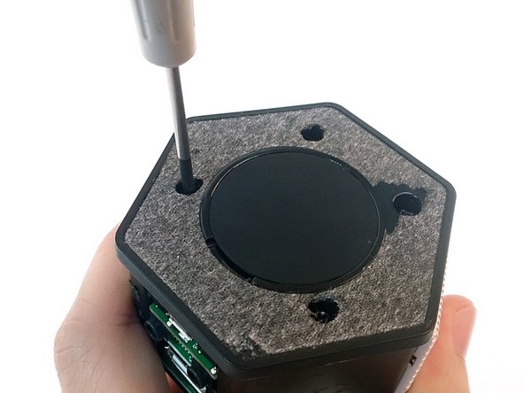

  16. Sound BlasterAxx AXX 200 Teardown, Opening the top panel: crwdns2935265:016crwdnd2935265:01crwdnd2935265:03crwdne2935265:0 Sound BlasterAxx AXX 200 Teardown, Opening the top panel: crwdns2935265:016crwdnd2935265:02crwdnd2935265:03crwdne2935265:0 Sound BlasterAxx AXX 200 Teardown, Opening the top panel: crwdns2935265:016crwdnd2935265:03crwdnd2935265:03crwdne2935265:0
    • Unscrew the six screws located at each corner of the top panel.
    • Then, remove the four screws in the center to open the top panel.
    • There are cables attached to the top panel. Open the top panel with care.
    • Unplug the NFC cable connected to the top panel.
    • Disconnect the flex connector to completely remove the top panel.

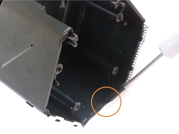

  19. Sound BlasterAxx AXX 200 Teardown, Removing metal grille: crwdns2935265:019crwdnd2935265:01crwdnd2935265:03crwdne2935265:0 Sound BlasterAxx AXX 200 Teardown, Removing metal grille: crwdns2935265:019crwdnd2935265:02crwdnd2935265:03crwdne2935265:0 Sound BlasterAxx AXX 200 Teardown, Removing metal grille: crwdns2935265:019crwdnd2935265:03crwdnd2935265:03crwdne2935265:0
    • The white metal grille at the front is also removable. If you find white a little understated, this would be the part where you break out the spray paint from the garage and go to town on this bad boy. A little unfortunate that you have to remove everything else before being able to remove the grille.
    • To remove the metal grille, pry open the two catches using a flathead screwdriver.
    • Lastly, slide the inner chamber out from the metal grille casing.
