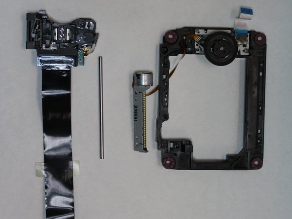

  4. Sony-BDP-SX1000 Laser Lens Replacement: crwdns2935265:04crwdnd2935265:01crwdnd2935265:03crwdne2935265:0 Sony-BDP-SX1000 Laser Lens Replacement: crwdns2935265:04crwdnd2935265:02crwdnd2935265:03crwdne2935265:0 Sony-BDP-SX1000 Laser Lens Replacement: crwdns2935265:04crwdnd2935265:03crwdnd2935265:03crwdne2935265:0
    • Remove the J0mm Phillips#0 screws shown in first picture to detach the slide motor from the laser tray.
    • Remove the white piece that attaches the laser lens to the slide motor and also take out the slide motor.

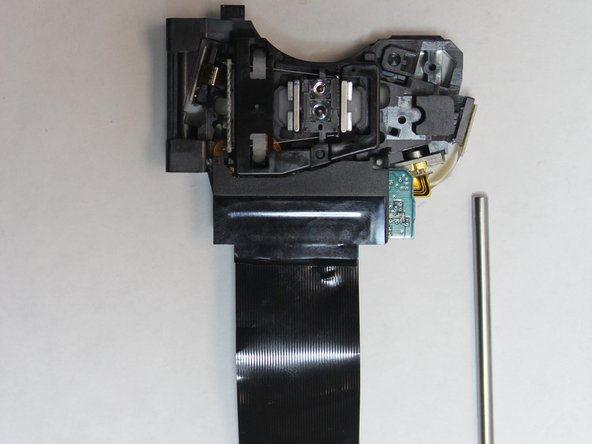

  6. Sony-BDP-SX1000 Laser Lens Replacement: crwdns2935265:06crwdnd2935265:01crwdnd2935265:03crwdne2935265:0 Sony-BDP-SX1000 Laser Lens Replacement: crwdns2935265:06crwdnd2935265:02crwdnd2935265:03crwdne2935265:0 Sony-BDP-SX1000 Laser Lens Replacement: crwdns2935265:06crwdnd2935265:03crwdnd2935265:03crwdne2935265:0
    • Remove the J0mm Phillips #0 screw which is shown in image one. This screw keeps the metal bar from sliding out. The laser lens is attached to this metal bar on one side and on the other side is the sliding motor.
    • Slide out the rod from its placement. This will detach the laser lens and the ribbon cable from the tray.
  7. Sony-BDP-SX1000 Laser Lens Replacement, Laser Lens: crwdns2935265:07crwdnd2935265:01crwdnd2935265:03crwdne2935265:0 Sony-BDP-SX1000 Laser Lens Replacement, Laser Lens: crwdns2935265:07crwdnd2935265:02crwdnd2935265:03crwdne2935265:0 Sony-BDP-SX1000 Laser Lens Replacement, Laser Lens: crwdns2935265:07crwdnd2935265:03crwdnd2935265:03crwdne2935265:0
    • In going through the steps to replace ribbon cable, you have gone through the necessary steps to remove the laser lens.
    • You can now remove the laser lens.
