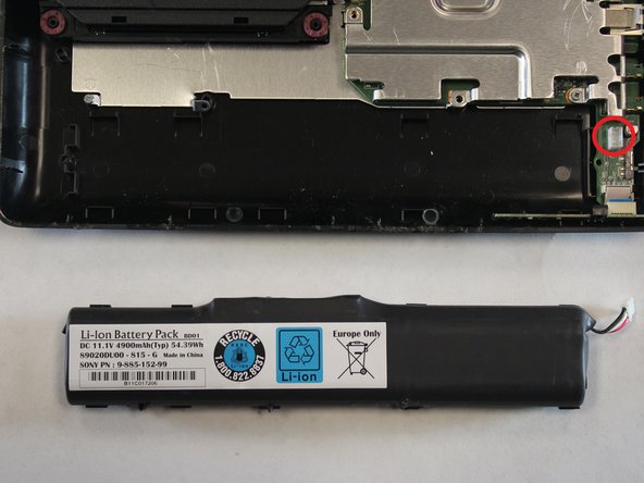

  3. Sony-BDP-SX1000 Battery Replacement, Battery: crwdns2935265:03crwdnd2935265:01crwdnd2935265:02crwdne2935265:0 Sony-BDP-SX1000 Battery Replacement, Battery: crwdns2935265:03crwdnd2935265:02crwdnd2935265:02crwdne2935265:0
    • The battery can be found at the bottom of the device.
    • Remove the battery by removing the white connector.
