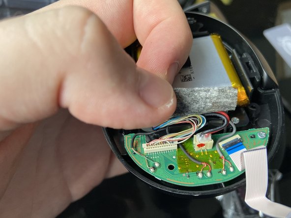

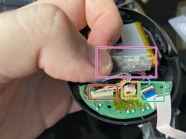

  4. Sony h.ear on 3 Touchpad Replacement, Locate the battery and touchpad connectors: crwdns2935265:05crwdnd2935265:01crwdnd2935265:03crwdne2935265:0 Sony h.ear on 3 Touchpad Replacement, Locate the battery and touchpad connectors: crwdns2935265:05crwdnd2935265:02crwdnd2935265:03crwdne2935265:0 Sony h.ear on 3 Touchpad Replacement, Locate the battery and touchpad connectors: crwdns2935265:05crwdnd2935265:03crwdnd2935265:03crwdne2935265:0
    • Gently peel back the foam tape with a spudger and unstick it from the two cables underneath.
    • The battery and headband cable held in place against the PCB and internal enclosure of the Right Speaker with foam tape. The ZIF connector the touchpad is to the side and not covered in tape.
    • Headband cable connector (under foam tape)
    • Battery connector (under foam tape)
    • ZIF connector for touchpad
    • Foam tape
  5. crwdns2935267:0crwdne2935267:0
    • Using tweezers, gently grab and pull the smaller connector up from the circuit board to disconnect the battery.
    • Be extra careful to make sure you don't puncture the battery with the tweezers.
    • Using a spudger, gently flip up the latch on the ZIF connector on the circuit board connecting the touchpad.
    • Gently lift the ribbon cable away.
