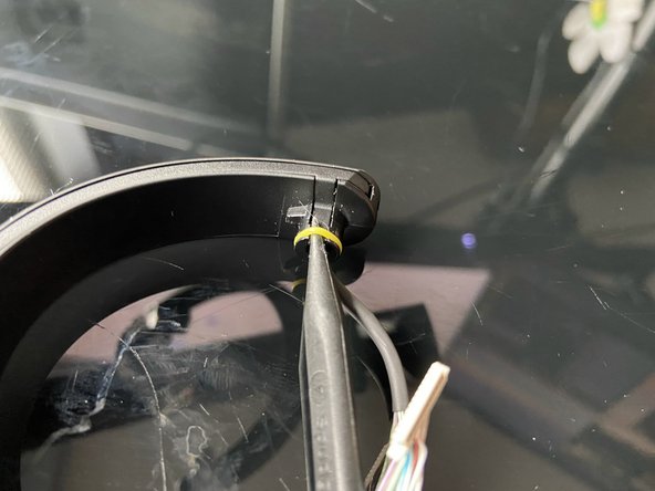

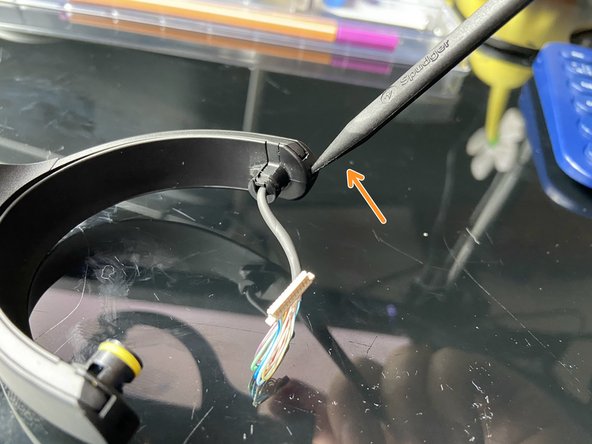

  4. Sony h.ear on 3 Headband Arch teardown, Unhook the thin case segment of the headband arch: crwdns2935265:04crwdnd2935265:01crwdnd2935265:03crwdne2935265:0 Sony h.ear on 3 Headband Arch teardown, Unhook the thin case segment of the headband arch: crwdns2935265:04crwdnd2935265:02crwdnd2935265:03crwdne2935265:0 Sony h.ear on 3 Headband Arch teardown, Unhook the thin case segment of the headband arch: crwdns2935265:04crwdnd2935265:03crwdnd2935265:03crwdne2935265:0
    • Insert the pointed end of a spudger into one of the holes at the very end of one of the headband arches.
    • Gently push upwards towards the thin arch casing above. This should unlatch the hook.
    • Repeat for all 4 ends of the headband arch.

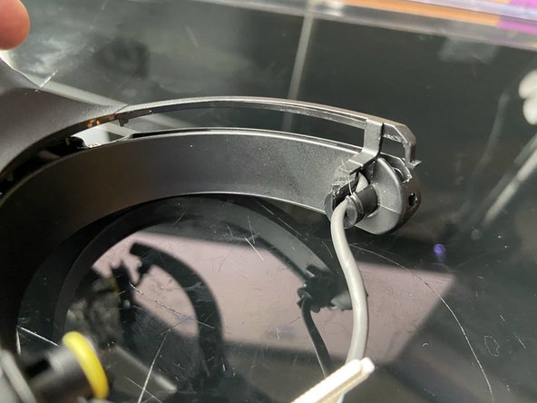

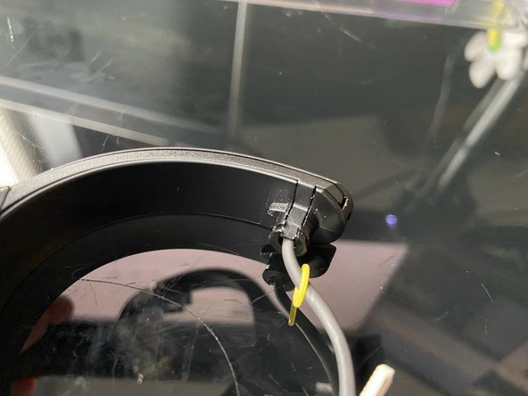

  5. Sony h.ear on 3 Headband Arch teardown, Unclip and slightly separate the thin arch segment: crwdns2935265:05crwdnd2935265:01crwdnd2935265:01crwdne2935265:0
    • Gently lift or pry away at the thin parts of the headband arch to separate the thin case segments from the deep case segments.
    • This part of the arch breaking is an incredibly common point of failure on these headphones, this step may not be necessary (and why I don't have pics of the process to offer myself!)
    • Gently separate the two, but do not fully separate them as they are still connected by the cable (which is held in with retaining brackets).

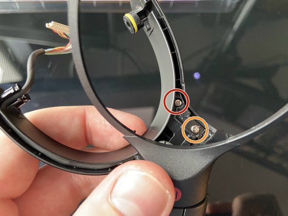

  6. Sony h.ear on 3 Headband Arch teardown, Unscrew the cable retaining bracket from the deep arch segment: crwdns2935265:06crwdnd2935265:01crwdnd2935265:02crwdne2935265:0 Sony h.ear on 3 Headband Arch teardown, Unscrew the cable retaining bracket from the deep arch segment: crwdns2935265:06crwdnd2935265:02crwdnd2935265:02crwdne2935265:0
    • Gently swivel the thin arch casing from the deep arch casing. This reveals two pairs of screws holding a cable retaining bracket in place at the base of the deep arch segment:
    • 2x ??? JIS (probably #000) screws
    • I did not keep track of how big the bits that I used to unscrew them were, sorry!
    • Unscrew the screws and remove the retaining bracket. Don't remove the cable yet.
