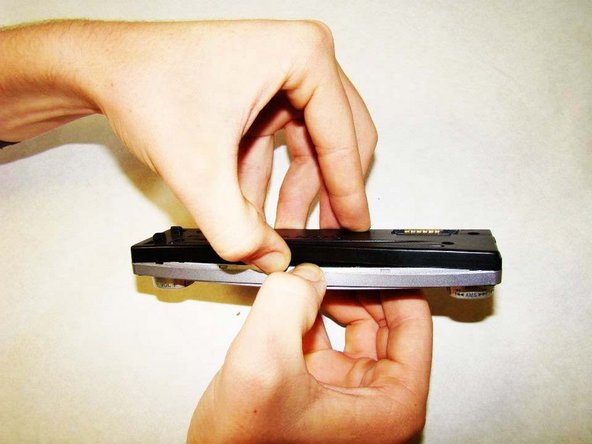

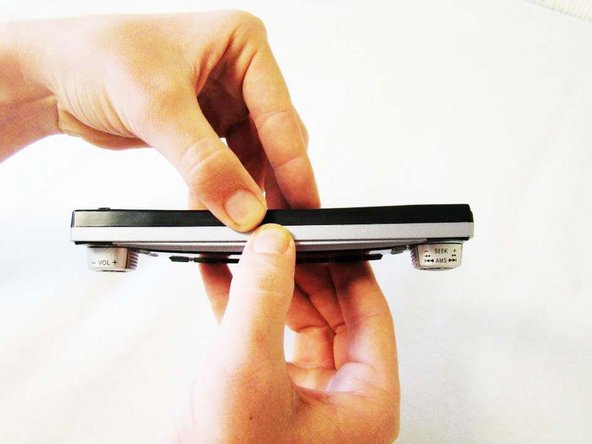

    • Use two fingers to create a small gap on the top of the faceplate, as indicated in the picture.

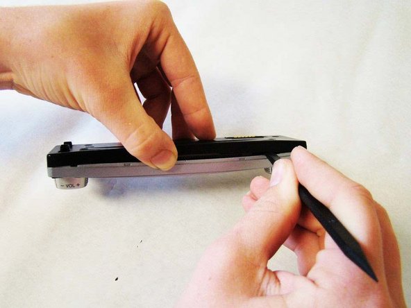

    • Insert the flat end of the Heavy-duty Spudger into the opening you created.
    • Slide it to the right carefully, until you feel the screen pop off.
    • Make sure you keep the face of the screen pointed down as you carefully lift off the freed black portion of the screen - as shown in the picture.

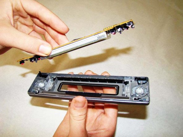

    • Gently grab the Front Motherboard - as indicated in the picture - and lift it from the rest of the screen.
