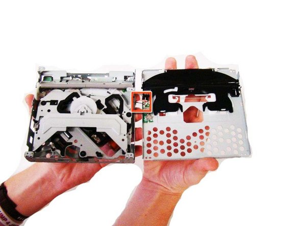

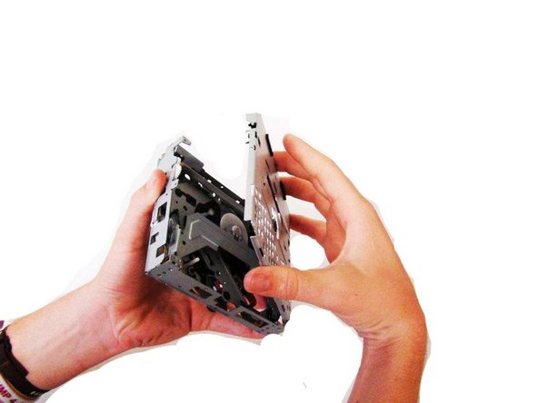

  13. Sony Xplod CDX-MP30 Jammed CD Replacement: crwdns2935265:013crwdnd2935265:01crwdnd2935265:03crwdne2935265:0 Sony Xplod CDX-MP30 Jammed CD Replacement: crwdns2935265:013crwdnd2935265:02crwdnd2935265:03crwdne2935265:0 Sony Xplod CDX-MP30 Jammed CD Replacement: crwdns2935265:013crwdnd2935265:03crwdnd2935265:03crwdne2935265:0
    • These two pieces will NOT separate completely. They are connected by small wires on one side. So make sure you follow the pictures carefully to know which side to pull up.
    • Grip the top of the CD-Drive and pull it up and over, as shown in the pictures.
    • Notice the wires that hold the two pieces together.

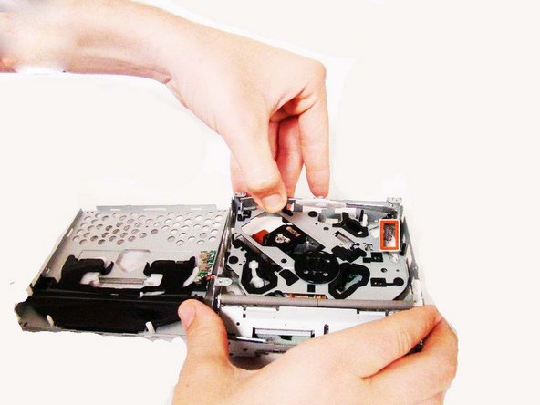

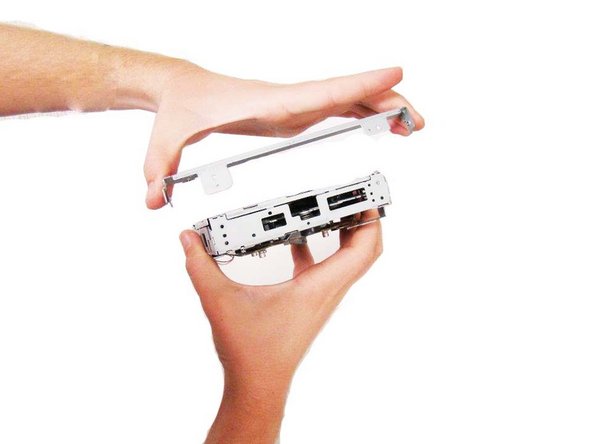

  14. Sony Xplod CDX-MP30 Jammed CD Replacement: crwdns2935265:014crwdnd2935265:01crwdnd2935265:02crwdne2935265:0 Sony Xplod CDX-MP30 Jammed CD Replacement: crwdns2935265:014crwdnd2935265:02crwdnd2935265:02crwdne2935265:0
    • Pay extra attention to the spring inside the CD-Drive. This will be crucial for the next step.
    • Slowly pull up the side opposite the spring, but make sure not to over-stretch the spring. This could damage the device.
    • While the part is lifted, remove your jammed CD, and you are finished!
