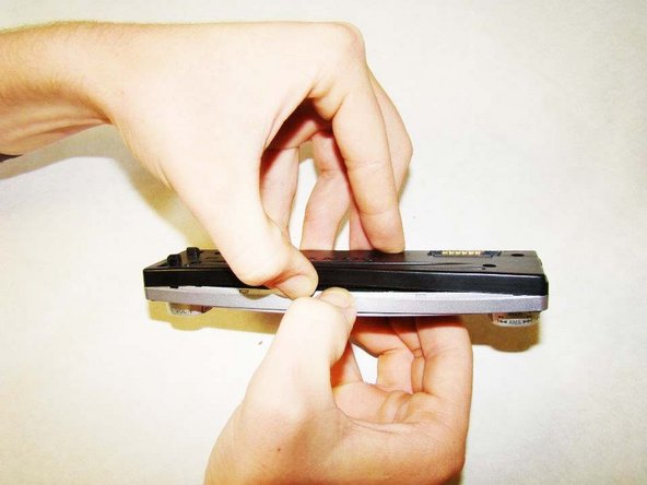

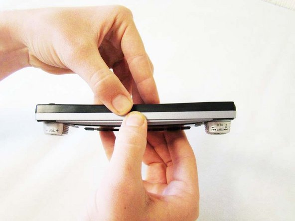

    • Use two fingers to create a small gap in the top of the faceplate, as indicated in the picture.

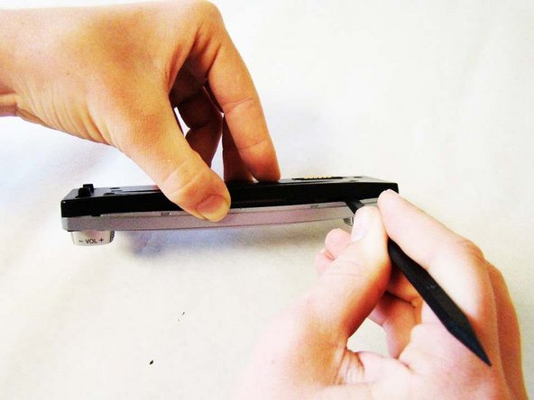

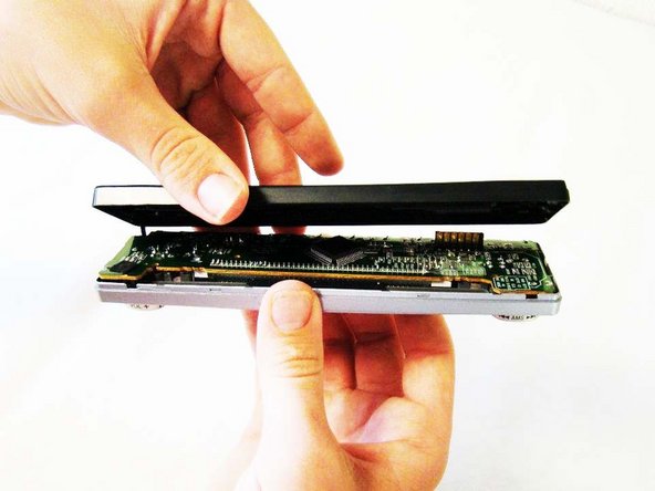

    • Insert the flat end of the Heavy-duty Spudger into the opening you created.
    • Slide it to the right carefully, until you feel the screen pop off.
    • Make sure you keep the face of the screen pointed down as you carefully lift off the freed black portion of the screen - as shown in the picture.

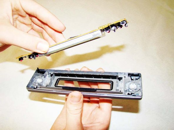

    • Gently grab the Front Motherboard - as indicated in the picture - and lift it from the rest of the screen.
  6. Sony Xplod CDX-MP30 Front Screen Motherboard Replacement: crwdns2935265:06crwdnd2935265:01crwdnd2935265:01crwdne2935265:0
    • To remove the LCD, please refer to the iFixit soldering guide.
    • Once the LCD screen is removed, you have unrestricted access to the front screen motherboard.
