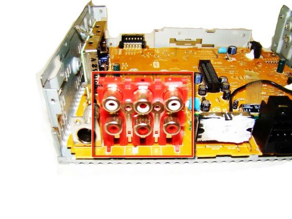

  12. Sony Xplod CDX-MP30 Audio In/Audio Out Inputs Replacement, Audio In/Audio Out Inputs: crwdns2935265:012crwdnd2935265:01crwdnd2935265:02crwdne2935265:0 Sony Xplod CDX-MP30 Audio In/Audio Out Inputs Replacement, Audio In/Audio Out Inputs: crwdns2935265:012crwdnd2935265:02crwdnd2935265:02crwdne2935265:0
    • To remove the Audio In/Audio Out inputs on the circuit board please refer to the iFixit soldering guide to assist you.
