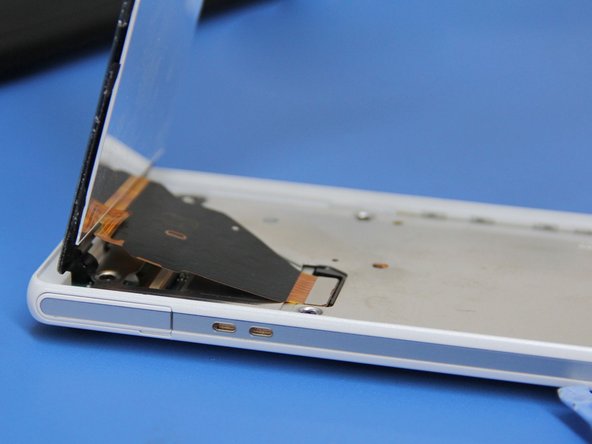

  4. Sony Xperia ZR C5503 Teardown: crwdns2935265:04crwdnd2935265:01crwdnd2935265:03crwdne2935265:0 Sony Xperia ZR C5503 Teardown: crwdns2935265:04crwdnd2935265:02crwdnd2935265:03crwdne2935265:0 Sony Xperia ZR C5503 Teardown: crwdns2935265:04crwdnd2935265:03crwdnd2935265:03crwdne2935265:0

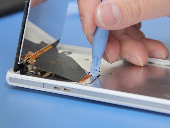

    • Use plastic opening tool to get the screen off.
    • Insert opening tool to the bottom edge of the screen. Then go along the edge slowly to separate the screen.
    • Try several times to get an easy point to insert opening tool. Don't force, although this screen is not that fragile.
    • Finally use opening tool to detach the screen panel connector.
    • Perform this step slowly. Be careful with the flex cable.

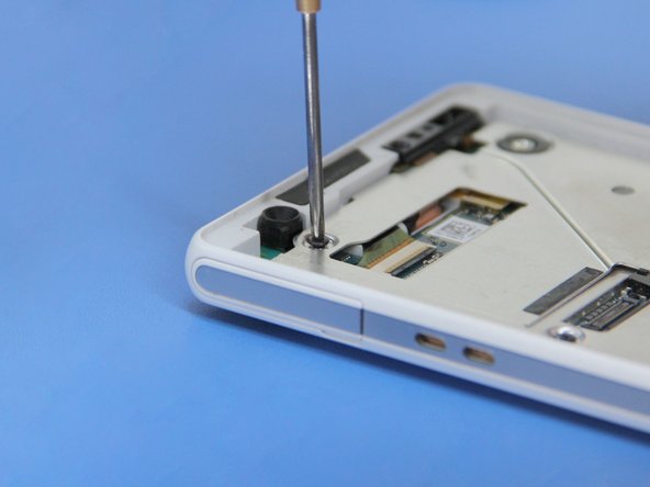

    • Get the partition between screen panel and motherboard out.
    • Firstly, use Phillips #00 Screwdriver to remove all the screws you can see on the partition.
    • Check next step first, don't hurry to pry the partition!
  6. Sony Xperia ZR C5503 Teardown: crwdns2935265:06crwdnd2935265:01crwdnd2935265:03crwdne2935265:0 Sony Xperia ZR C5503 Teardown: crwdns2935265:06crwdnd2935265:02crwdnd2935265:03crwdne2935265:0 Sony Xperia ZR C5503 Teardown: crwdns2935265:06crwdnd2935265:03crwdnd2935265:03crwdne2935265:0

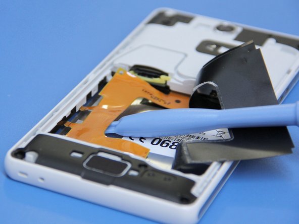

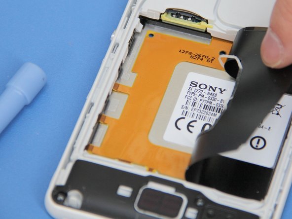

    • Gently pry the partition out a little, you can see there's volume button flex cable sticking on the partition panel. So if you pry too hard, these flex cable may be torn.
    • Flip the phone.
    • Lift the black sticky plastic paper slowly and then you'll see the flex cable sticky on the partition.
    • Use plastic opening tool to separate the flex cable.
    • Perform this step gently and slowly in case of tearing it.

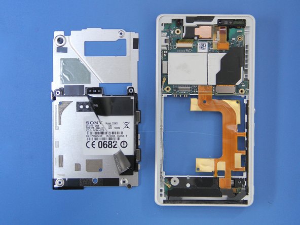

    • Now the partition is easy to get out.
    • Then you can see the motherboard.
