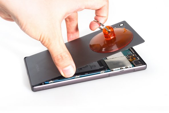

    • Heat the back cover to soften the adhesive.
    • Place the suction cup and insert metal opening tool to open a gap from top side.
  3. Sony Xperia Z5 Teardown: crwdns2935265:03crwdnd2935265:01crwdnd2935265:03crwdne2935265:0 Sony Xperia Z5 Teardown: crwdns2935265:03crwdnd2935265:02crwdnd2935265:03crwdne2935265:0 Sony Xperia Z5 Teardown: crwdns2935265:03crwdnd2935265:03crwdnd2935265:03crwdne2935265:0
    • Insert the guitar picks and slide it to cut the adhesive underneath.
    • Remove back cover. The back cover is glass, so only use a sucker if you're experienced. otherwise use a small blade to lift off the back while the glue is soft.

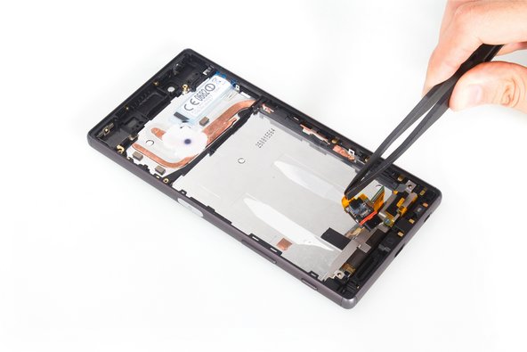

    • Release rear camera connector, front camera connector, audio jack flex connector and main flex connector on the motherboard and remove the screws there.
    • Take away the plastic bracket.

    • Remove metal cover securing loudspeaker and twist off screws.
    • Pry up and loosen the bottom side of main flex assembly.

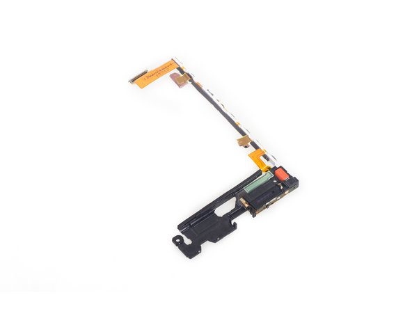

  7. Sony Xperia Z5 Teardown: crwdns2935265:07crwdnd2935265:01crwdnd2935265:02crwdne2935265:0 Sony Xperia Z5 Teardown: crwdns2935265:07crwdnd2935265:02crwdnd2935265:02crwdne2935265:0

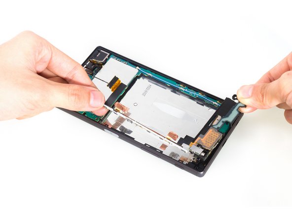

    • Remove main flex. ( Attention: the fingerprint sensor connector is here, be careful to loosen it)
  8. Sony Xperia Z5 Teardown: crwdns2935265:08crwdnd2935265:01crwdnd2935265:02crwdne2935265:0 Sony Xperia Z5 Teardown: crwdns2935265:08crwdnd2935265:02crwdnd2935265:02crwdne2935265:0
    • This is main flex assembly. (It comes with loudspeaker and vibration motor )

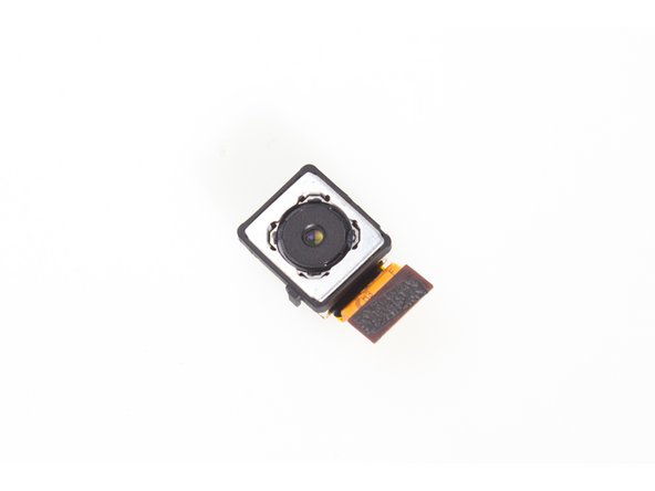

    • Remove rear camera.

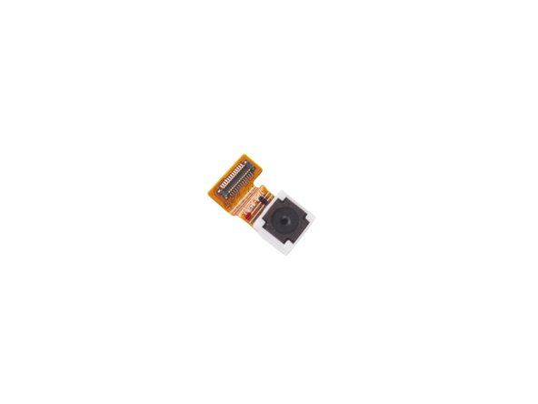

    • Remove that securing bracket, then remove front camera.

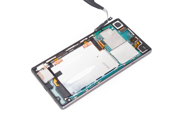

    • Release connectors on the motherboard.
    • Remove motherboard.

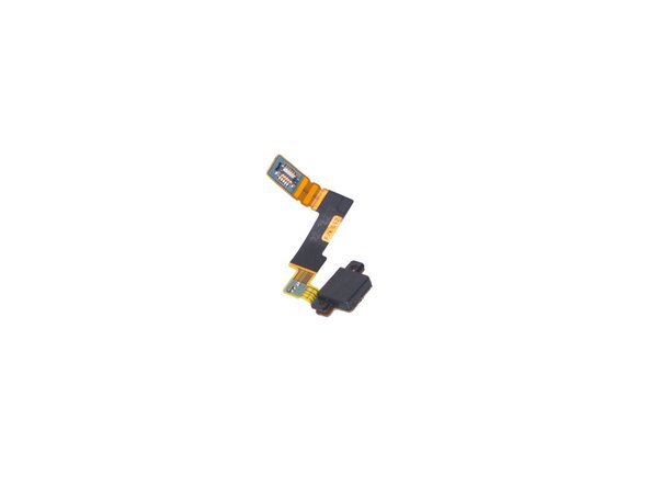

    • Remover cover bracket on the audio jack.
    • Cut adhesive at the top of the audio jack and noise canceling mic, then remove it.
  13. Sony Xperia Z5 Teardown: crwdns2935265:013crwdnd2935265:01crwdnd2935265:01crwdne2935265:0
    • This is audio jack flex coming with noise canceling mic.

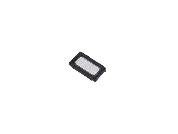

  14. Sony Xperia Z5 Teardown: crwdns2935265:014crwdnd2935265:01crwdnd2935265:03crwdne2935265:0 Sony Xperia Z5 Teardown: crwdns2935265:014crwdnd2935265:02crwdnd2935265:03crwdne2935265:0 Sony Xperia Z5 Teardown: crwdns2935265:014crwdnd2935265:03crwdnd2935265:03crwdne2935265:0

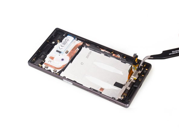

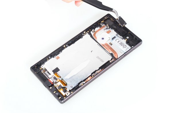

    • Cut the adhesive underneath the earpiece and remove the earpiece.
  15. Sony Xperia Z5 Teardown: crwdns2935265:015crwdnd2935265:01crwdnd2935265:03crwdne2935265:0 Sony Xperia Z5 Teardown: crwdns2935265:015crwdnd2935265:02crwdnd2935265:03crwdne2935265:0 Sony Xperia Z5 Teardown: crwdns2935265:015crwdnd2935265:03crwdnd2935265:03crwdne2935265:0

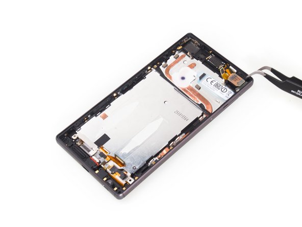

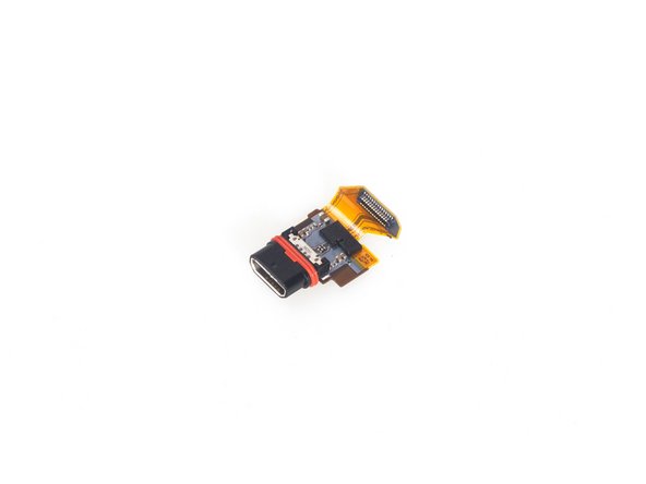

    • Push the charging port flex out of the slot and remove it.
  16. Sony Xperia Z5 Teardown: crwdns2935265:016crwdnd2935265:01crwdnd2935265:03crwdne2935265:0 Sony Xperia Z5 Teardown: crwdns2935265:016crwdnd2935265:02crwdnd2935265:03crwdne2935265:0 Sony Xperia Z5 Teardown: crwdns2935265:016crwdnd2935265:03crwdnd2935265:03crwdne2935265:0
