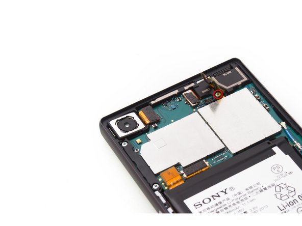

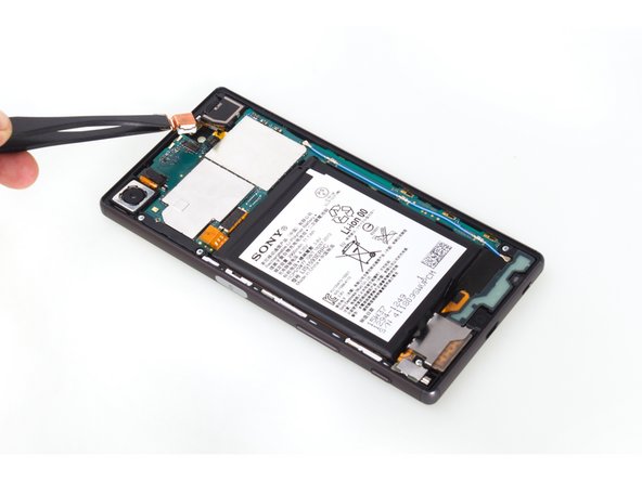

  3. Sony Xperia Z5 Front Camera Replacement: crwdns2935265:03crwdnd2935265:01crwdnd2935265:01crwdne2935265:0
    • Release battery connector in order to prevent short circuit.
  4. Sony Xperia Z5 Front Camera Replacement: crwdns2935265:04crwdnd2935265:01crwdnd2935265:03crwdne2935265:0 Sony Xperia Z5 Front Camera Replacement: crwdns2935265:04crwdnd2935265:02crwdnd2935265:03crwdne2935265:0 Sony Xperia Z5 Front Camera Replacement: crwdns2935265:04crwdnd2935265:03crwdnd2935265:03crwdne2935265:0
    • Release audio jack flex connector and twist off the Phillips screws underneath.
    • Remove the plastic bracket securing the front camera.
  5. Sony Xperia Z5 Front Camera Replacement: crwdns2935265:05crwdnd2935265:01crwdnd2935265:03crwdne2935265:0 Sony Xperia Z5 Front Camera Replacement: crwdns2935265:05crwdnd2935265:02crwdnd2935265:03crwdne2935265:0 Sony Xperia Z5 Front Camera Replacement: crwdns2935265:05crwdnd2935265:03crwdnd2935265:03crwdne2935265:0
    • Release front camera connector and remove front camera.
