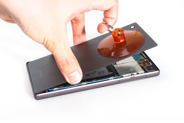

  2. Sony Xperia Z5 Charging Port Flex Replacement: crwdns2935265:02crwdnd2935265:01crwdnd2935265:02crwdne2935265:0 Sony Xperia Z5 Charging Port Flex Replacement: crwdns2935265:02crwdnd2935265:02crwdnd2935265:02crwdne2935265:0
    • Heat the back cover to soften the adhesive sticker.
    • Place the suction cup and inert metal opening tool to open a gap from top side.
  3. Sony Xperia Z5 Charging Port Flex Replacement: crwdns2935265:03crwdnd2935265:01crwdnd2935265:03crwdne2935265:0 Sony Xperia Z5 Charging Port Flex Replacement: crwdns2935265:03crwdnd2935265:02crwdnd2935265:03crwdne2935265:0 Sony Xperia Z5 Charging Port Flex Replacement: crwdns2935265:03crwdnd2935265:03crwdnd2935265:03crwdne2935265:0
    • Insert the guitar pick and slide it to cut the adhesive sticker underneath.
    • Remove back cover.

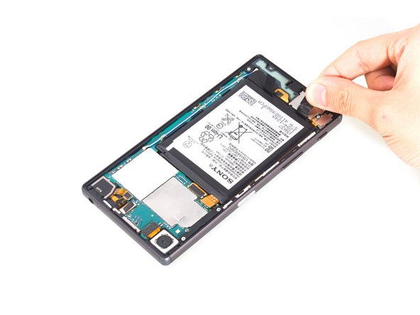

  4. Sony Xperia Z5 Charging Port Flex Replacement: crwdns2935265:04crwdnd2935265:01crwdnd2935265:03crwdne2935265:0 Sony Xperia Z5 Charging Port Flex Replacement: crwdns2935265:04crwdnd2935265:02crwdnd2935265:03crwdne2935265:0 Sony Xperia Z5 Charging Port Flex Replacement: crwdns2935265:04crwdnd2935265:03crwdnd2935265:03crwdne2935265:0
    • Release battery connector and pull off the adhesive tape underneath.
    • Pry up battery.

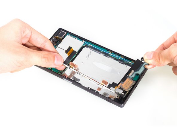

  7. Sony Xperia Z5 Charging Port Flex Replacement: crwdns2935265:07crwdnd2935265:01crwdnd2935265:02crwdne2935265:0 Sony Xperia Z5 Charging Port Flex Replacement: crwdns2935265:07crwdnd2935265:02crwdnd2935265:02crwdne2935265:0
    • Remove main flex. ( Attention: the fingerprint sensor connector is here, be careful to loosen it)

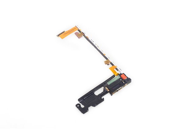

  8. Sony Xperia Z5 Charging Port Flex Replacement: crwdns2935265:08crwdnd2935265:01crwdnd2935265:02crwdne2935265:0 Sony Xperia Z5 Charging Port Flex Replacement: crwdns2935265:08crwdnd2935265:02crwdnd2935265:02crwdne2935265:0
    • This is main flex assembly. (It comes with loudspeaker and vibration motor )

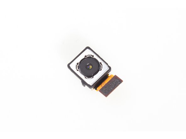

  9. Sony Xperia Z5 Charging Port Flex Replacement: crwdns2935265:09crwdnd2935265:01crwdnd2935265:02crwdne2935265:0 Sony Xperia Z5 Charging Port Flex Replacement: crwdns2935265:09crwdnd2935265:02crwdnd2935265:02crwdne2935265:0
    • Remove rear camera.

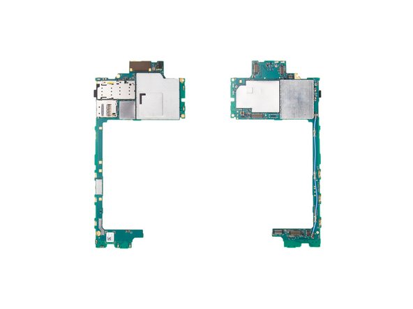

  11. Sony Xperia Z5 Charging Port Flex Replacement: crwdns2935265:011crwdnd2935265:01crwdnd2935265:03crwdne2935265:0 Sony Xperia Z5 Charging Port Flex Replacement: crwdns2935265:011crwdnd2935265:02crwdnd2935265:03crwdne2935265:0 Sony Xperia Z5 Charging Port Flex Replacement: crwdns2935265:011crwdnd2935265:03crwdnd2935265:03crwdne2935265:0
    • Release connectors on the motherboard. Remove motherboard.

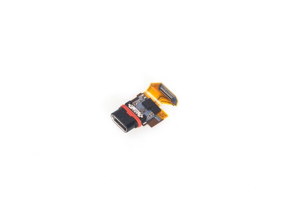

  12. Sony Xperia Z5 Charging Port Flex Replacement: crwdns2935265:012crwdnd2935265:01crwdnd2935265:03crwdne2935265:0 Sony Xperia Z5 Charging Port Flex Replacement: crwdns2935265:012crwdnd2935265:02crwdnd2935265:03crwdne2935265:0 Sony Xperia Z5 Charging Port Flex Replacement: crwdns2935265:012crwdnd2935265:03crwdnd2935265:03crwdne2935265:0
    • Remove charging port flex.
