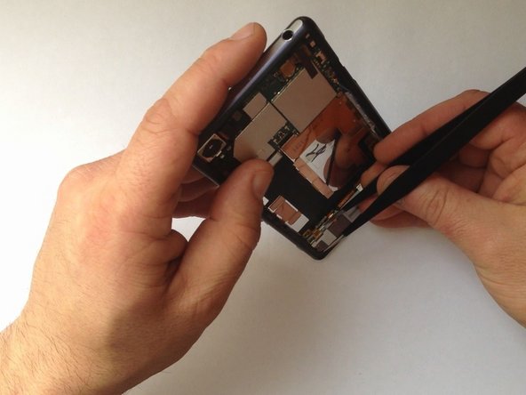

  5. Sony Xperia Z2 Loudspeaker Replacement, Loudspeaker: crwdns2935265:05crwdnd2935265:01crwdnd2935265:03crwdne2935265:0 Sony Xperia Z2 Loudspeaker Replacement, Loudspeaker: crwdns2935265:05crwdnd2935265:02crwdnd2935265:03crwdne2935265:0 Sony Xperia Z2 Loudspeaker Replacement, Loudspeaker: crwdns2935265:05crwdnd2935265:03crwdnd2935265:03crwdne2935265:0
    • Remove the Loudspeaker metal bracket.
  6. Sony Xperia Z2 Loudspeaker Replacement: crwdns2935265:06crwdnd2935265:01crwdnd2935265:03crwdne2935265:0 Sony Xperia Z2 Loudspeaker Replacement: crwdns2935265:06crwdnd2935265:02crwdnd2935265:03crwdne2935265:0 Sony Xperia Z2 Loudspeaker Replacement: crwdns2935265:06crwdnd2935265:03crwdnd2935265:03crwdne2935265:0
    • Part of the Volume/PowerON/Mic flex cable is affixed onto the Loudspeaker/Vibro motor module.
    • Under the Flex cable is the Loudspeaker.
    • You can change only the Loudspeaker or or the Loudspeaker & Holder module.
    • Loudspeaker & Holder module Part No: 1282-2013
