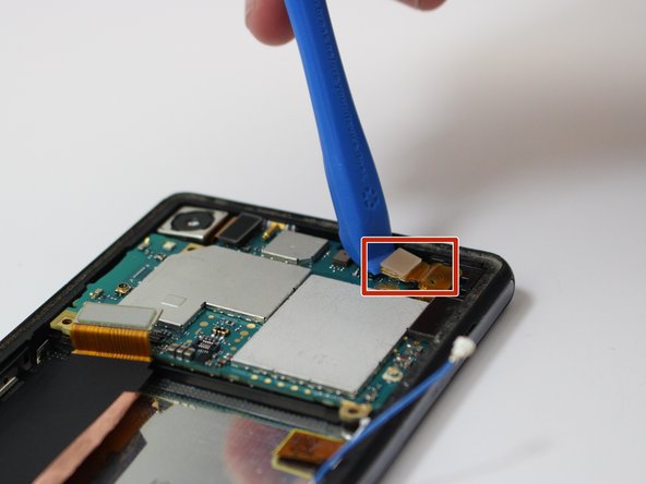

  4. Sony Xperia Z1 Screen Replacement: crwdns2935265:04crwdnd2935265:01crwdnd2935265:02crwdne2935265:0 Sony Xperia Z1 Screen Replacement: crwdns2935265:04crwdnd2935265:02crwdnd2935265:02crwdne2935265:0
    • Use the plastic opening tool to gently pry off the two flex connectors from the motherboard. Getting access to one of the connectors requires prying off the other first, so be sure to remove the top connector first.
    • Tip: you may need to use the tweezers to gently hold the top connector out of the way while prying off the bottom connector.

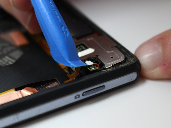

    • Using an opening tool, disconnect the two press fit connectors from the bottom and top right of the motherboard.
  11. Sony Xperia Z1 Screen Replacement: crwdns2935265:011crwdnd2935265:01crwdnd2935265:03crwdne2935265:0 Sony Xperia Z1 Screen Replacement: crwdns2935265:011crwdnd2935265:02crwdnd2935265:03crwdne2935265:0 Sony Xperia Z1 Screen Replacement: crwdns2935265:011crwdnd2935265:03crwdnd2935265:03crwdne2935265:0

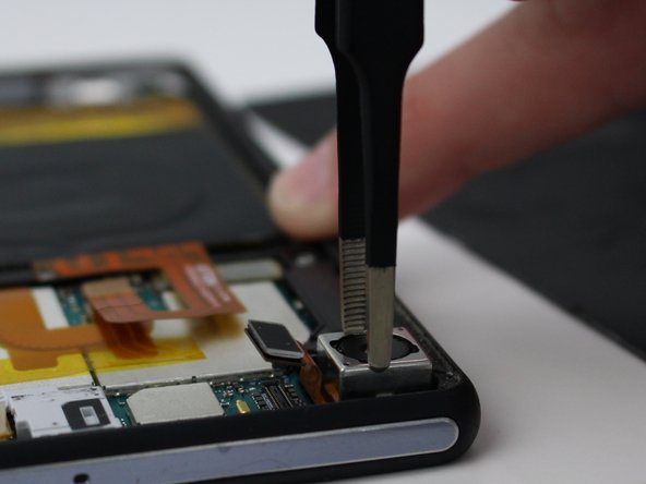

    • Use a plastic opening tool to pry up the camera's press fit connector in the top left corner of the motherboard.
    • Use a pair of tweezers to lift the camera out from the motherboard.

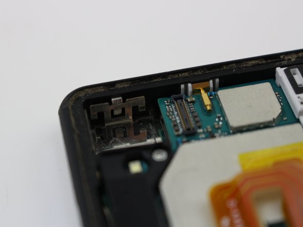

  13. Sony Xperia Z1 Screen Replacement: crwdns2935265:013crwdnd2935265:01crwdnd2935265:03crwdne2935265:0 Sony Xperia Z1 Screen Replacement: crwdns2935265:013crwdnd2935265:02crwdnd2935265:03crwdne2935265:0 Sony Xperia Z1 Screen Replacement: crwdns2935265:013crwdnd2935265:03crwdnd2935265:03crwdne2935265:0
    • Use an opening tool to disconnect the small white cable from the top left corner of the motherboard.
    • Remove the two screws from the daughterboard with a Torx T5 screwdriver.

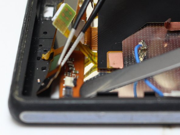

    • Detach the other end of the blue coaxial cable with a plastic opening tool.
    • Start to pry up the daughterboard using a plastic spudger, taking caution not to sever any of the attached ribbon cables.
    • Although the images depict the use of a metal spudger to pry up the daughterboard, we recommend using an ESD-safe tool instead to reduce the risk of damage to the componentry.

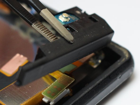

  15. Sony Xperia Z1 Screen Replacement: crwdns2935265:015crwdnd2935265:01crwdnd2935265:03crwdne2935265:0 Sony Xperia Z1 Screen Replacement: crwdns2935265:015crwdnd2935265:02crwdnd2935265:03crwdne2935265:0 Sony Xperia Z1 Screen Replacement: crwdns2935265:015crwdnd2935265:03crwdnd2935265:03crwdne2935265:0

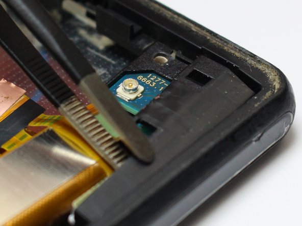

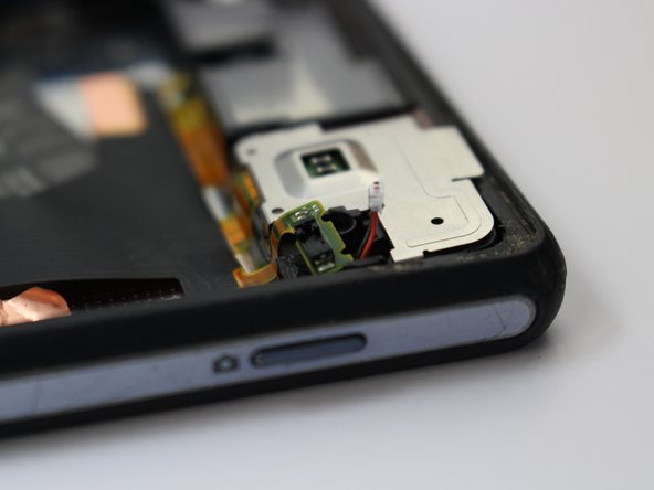

    • Lift up the daughterboard, holding it out of the way, but not removing it completely yet.
    • Pull out the black plastic bracket from the corner of the device with a pair of tweezers.
  16. Sony Xperia Z1 Screen Replacement: crwdns2935265:016crwdnd2935265:01crwdnd2935265:03crwdne2935265:0 Sony Xperia Z1 Screen Replacement: crwdns2935265:016crwdnd2935265:02crwdnd2935265:03crwdne2935265:0 Sony Xperia Z1 Screen Replacement: crwdns2935265:016crwdnd2935265:03crwdnd2935265:03crwdne2935265:0
    • Disconnect all of the press fit connectors from the circuit board beneath the daughterboard using a plastic opening tool.

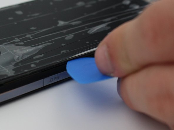

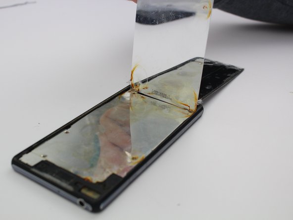

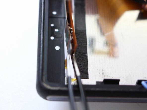

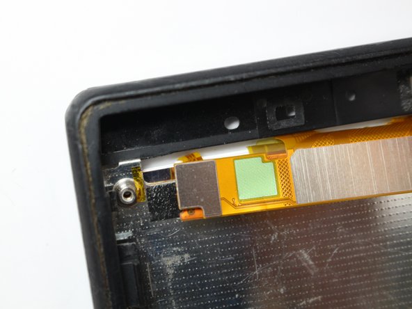

    • Now turn the phone back over to begin removing the screen. Using a heat gun, if possible, heat all edges of the screen in order to loosen the adhesive.
    • Next, use an opening pick to begin prying the screen from the device. Make sure to be careful, as it is common for the screen to shatter when removing it. Once removed, note where it is connected.
  18. Sony Xperia Z1 Screen Replacement: crwdns2935265:018crwdnd2935265:01crwdnd2935265:03crwdne2935265:0 Sony Xperia Z1 Screen Replacement: crwdns2935265:018crwdnd2935265:02crwdnd2935265:03crwdne2935265:0 Sony Xperia Z1 Screen Replacement: crwdns2935265:018crwdnd2935265:03crwdnd2935265:03crwdne2935265:0
    • Turn your attention back to the inside of the device, where there is one group of cables connected to the display on the front of the phone. Maneuver these cables, as shown, through the hole so that the screen and cables can be removed from the device. The screen and attached cables will now detach from the phone.
