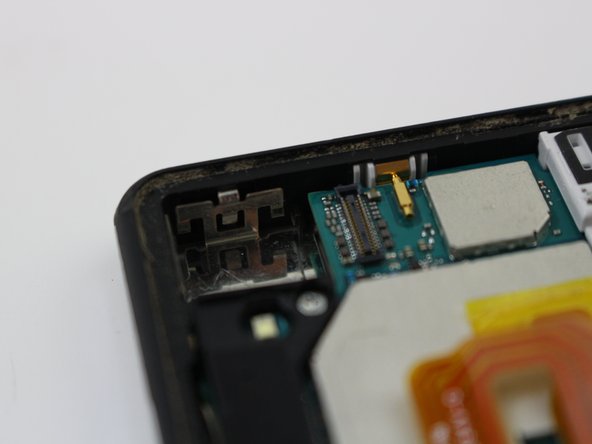

    • With caution to hot temperatures, glide a heat gun over the outer edges of the phone bezel to soften the adhesive securing the back panel to the phone.
  2. Sony Xperia Z1 Rear Camera Replacement: crwdns2935265:02crwdnd2935265:01crwdnd2935265:02crwdne2935265:0 Sony Xperia Z1 Rear Camera Replacement: crwdns2935265:02crwdnd2935265:02crwdnd2935265:02crwdne2935265:0
    • Apply a suction cup tool to the center of the back panel and gently pull the panel off the back of the phone.
    • If you are experiencing difficulty, use a plastic opening pick to slide into the crack in between the panel and the rest of the phone body to pry off the back.
  3. Sony Xperia Z1 Rear Camera Replacement: crwdns2935265:03crwdnd2935265:01crwdnd2935265:02crwdne2935265:0 Sony Xperia Z1 Rear Camera Replacement: crwdns2935265:03crwdnd2935265:02crwdnd2935265:02crwdne2935265:0
    • Using the plastic opening tool, carefully pry off the flex connector beside the camera housing.
  4. Sony Xperia Z1 Rear Camera Replacement: crwdns2935265:04crwdnd2935265:01crwdnd2935265:02crwdne2935265:0 Sony Xperia Z1 Rear Camera Replacement: crwdns2935265:04crwdnd2935265:02crwdnd2935265:02crwdne2935265:0
    • Use the tweezers to pull the camera out of the top left corner of the phone.
