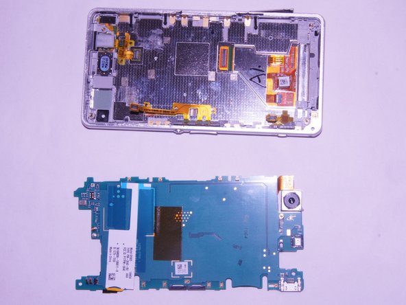

    1. Sony Xperia Z1 Compact Motherboard Replacement, Motherboard: crwdns2935265:013crwdnd2935265:01crwdnd2935265:02crwdne2935265:0 Sony Xperia Z1 Compact Motherboard Replacement, Motherboard: crwdns2935265:013crwdnd2935265:02crwdnd2935265:02crwdne2935265:0
      • Remove the square rubber gasket from the camera using the plastic spudger.
    2. Sony Xperia Z1 Compact Motherboard Replacement: crwdns2935265:014crwdnd2935265:01crwdnd2935265:02crwdne2935265:0 Sony Xperia Z1 Compact Motherboard Replacement: crwdns2935265:014crwdnd2935265:02crwdnd2935265:02crwdne2935265:0
      • Remove the black plastic corner still holding in the motherboard.

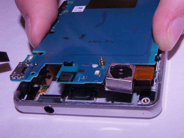

    3. Sony Xperia Z1 Compact Motherboard Replacement: crwdns2935265:015crwdnd2935265:01crwdnd2935265:03crwdne2935265:0 Sony Xperia Z1 Compact Motherboard Replacement: crwdns2935265:015crwdnd2935265:02crwdnd2935265:03crwdne2935265:0 Sony Xperia Z1 Compact Motherboard Replacement: crwdns2935265:015crwdnd2935265:03crwdnd2935265:03crwdne2935265:0
      • Carefully pry up on the four sides of the motherboard using the plastic spudger til it separates from the base of the phone.
    4. Sony Xperia Z1 Compact Motherboard Replacement: crwdns2935265:016crwdnd2935265:01crwdnd2935265:03crwdne2935265:0 Sony Xperia Z1 Compact Motherboard Replacement: crwdns2935265:016crwdnd2935265:02crwdnd2935265:03crwdne2935265:0 Sony Xperia Z1 Compact Motherboard Replacement: crwdns2935265:016crwdnd2935265:03crwdnd2935265:03crwdne2935265:0
      • Remove the motherboard from the device.
      • There may be a small yellow adhesive underneath the motherboard still holding it in. Slide the tip of the spudger through it to sever it.
