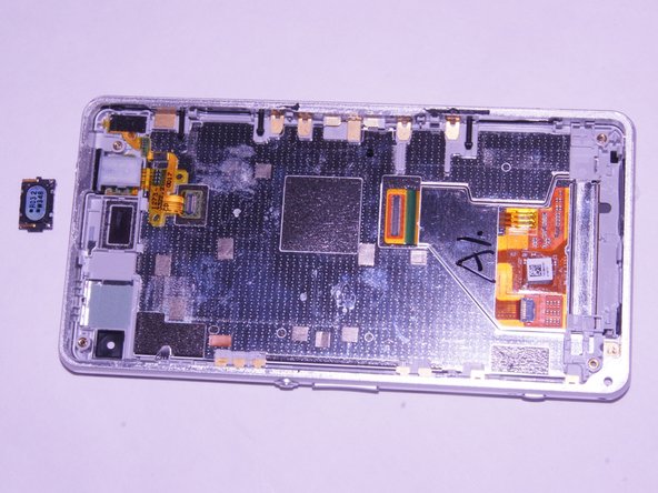

  17. Sony Xperia Z1 Compact Earpiece Speaker Replacement, Earpiece Speaker: crwdns2935265:017crwdnd2935265:01crwdnd2935265:02crwdne2935265:0 Sony Xperia Z1 Compact Earpiece Speaker Replacement, Earpiece Speaker: crwdns2935265:017crwdnd2935265:02crwdnd2935265:02crwdne2935265:0
    • Pry up on the earpiece from the left side to remove it.
    • There is a strong adhesive below the ear piece.
