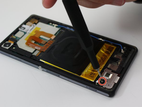

  3. Sony Xperia Z1 Charging Port Replacement: crwdns2935265:03crwdnd2935265:01crwdnd2935265:02crwdne2935265:0 Sony Xperia Z1 Charging Port Replacement: crwdns2935265:03crwdnd2935265:02crwdnd2935265:02crwdne2935265:0
    • Use the Torx T5 screwdriver to remove the two 3.81mm screws from the corners of the battery.

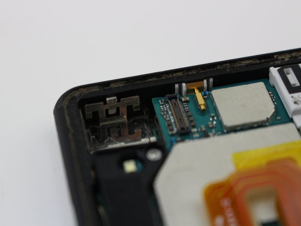

  9. Sony Xperia Z1 Charging Port Replacement: crwdns2935265:09crwdnd2935265:01crwdnd2935265:01crwdne2935265:0
    • Use a pair of tweezers to remove the plastic cover above the speakers.
  10. Sony Xperia Z1 Charging Port Replacement: crwdns2935265:010crwdnd2935265:01crwdnd2935265:01crwdne2935265:0
    • Use a plastic opening tool to remove the coaxial cable from the bottom of the motherboard by prying it upward.
  11. Sony Xperia Z1 Charging Port Replacement: crwdns2935265:011crwdnd2935265:01crwdnd2935265:01crwdne2935265:0
    • Using the plastic opening tool, remove the press fit connector attached to the motherboard.
  12. Sony Xperia Z1 Charging Port Replacement: crwdns2935265:012crwdnd2935265:01crwdnd2935265:01crwdne2935265:0
    • Using the plastic opening tool, remove the press fit connector attached to the motherboard in the upper righthand corner.

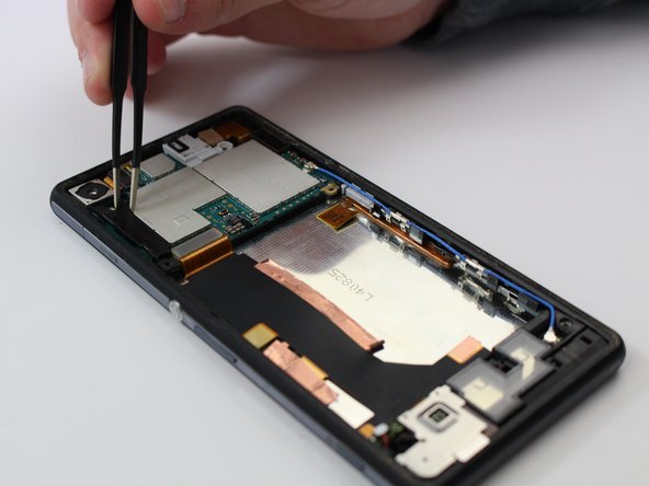

  13. Sony Xperia Z1 Charging Port Replacement: crwdns2935265:013crwdnd2935265:01crwdnd2935265:02crwdne2935265:0 Sony Xperia Z1 Charging Port Replacement: crwdns2935265:013crwdnd2935265:02crwdnd2935265:02crwdne2935265:0
    • Using the plastic opening tool, remove the press fit camera connector from the motherboard.
    • Lift the camera out from the motherboard.

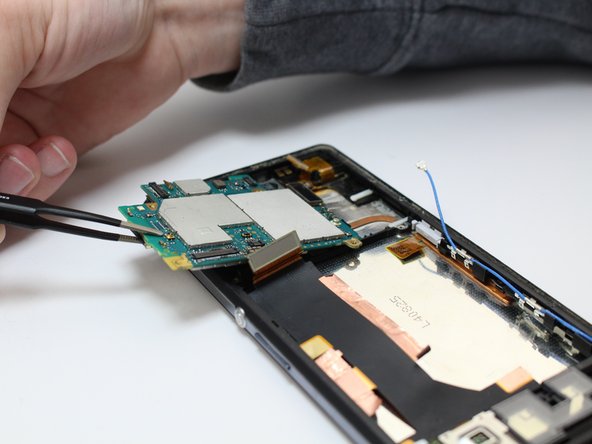

  14. Sony Xperia Z1 Charging Port Replacement: crwdns2935265:014crwdnd2935265:01crwdnd2935265:03crwdne2935265:0 Sony Xperia Z1 Charging Port Replacement: crwdns2935265:014crwdnd2935265:02crwdnd2935265:03crwdne2935265:0 Sony Xperia Z1 Charging Port Replacement: crwdns2935265:014crwdnd2935265:03crwdnd2935265:03crwdne2935265:0
    • Using a plastic spudger, lift the motherboard upwards in order to separate it from the phone.
    • The images depict a metal spudger being used, which poses a potential to damage the motherboard. We recommend using an ESD-safe tool instead.
    • As the motherboard is lifted up, grab it with a pair of tweezers and lift it out of the phone.
  15. Sony Xperia Z1 Charging Port Replacement: crwdns2935265:015crwdnd2935265:01crwdnd2935265:02crwdne2935265:0 Sony Xperia Z1 Charging Port Replacement: crwdns2935265:015crwdnd2935265:02crwdnd2935265:02crwdne2935265:0
    • Grab your Soldering Iron and heat it up. Once it is at around 200° F, apply pressure to the soldering pads on the left and right side of the connector. In order to replace the charging port, grab your connector and solder it back onto the same soldering pads.
