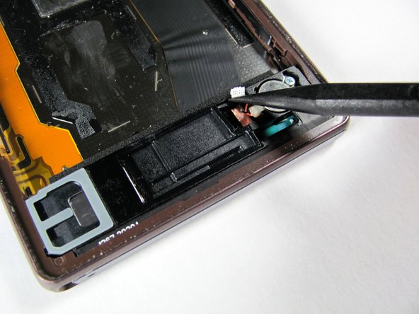

    • Disconnect the vibrate motor flux cable by using the spudger to gently pop it up.
  10. Sony Xperia Z Vibrate Motor Replacement: crwdns2935265:010crwdnd2935265:01crwdnd2935265:01crwdne2935265:0
    • Remove the single 3 mm screw, set next to the vibrate motor, using a Philips #000 screw driver.
  11. Sony Xperia Z Vibrate Motor Replacement: crwdns2935265:011crwdnd2935265:01crwdnd2935265:02crwdne2935265:0 Sony Xperia Z Vibrate Motor Replacement: crwdns2935265:011crwdnd2935265:02crwdnd2935265:02crwdne2935265:0
    • Use the spudger to firmly pry up the plastic housing holding the vibrate motor and loud speaker.
    • Be careful not to pull the plastic housing out right away. The antenna circuit board is still connected to the main body and the antenna could be damaged if pulled on.
    • Start on the left and slowly move to the right while prying up the adhesive and clips holding the plastic unit down.

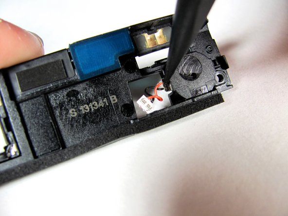

  13. Sony Xperia Z Vibrate Motor Replacement: crwdns2935265:013crwdnd2935265:01crwdnd2935265:03crwdne2935265:0 Sony Xperia Z Vibrate Motor Replacement: crwdns2935265:013crwdnd2935265:02crwdnd2935265:03crwdne2935265:0 Sony Xperia Z Vibrate Motor Replacement: crwdns2935265:013crwdnd2935265:03crwdnd2935265:03crwdne2935265:0
    • You now have access to the vibrate motor, the small round metallic object.
    • Flip the plastic housing over so that the vibrate motor is barely visible. With the pointy end of the spudger, slowly begin to work it loose from the housing by gently pushing down.
