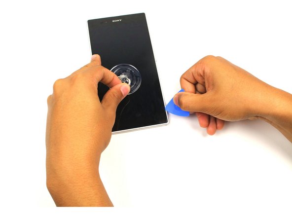

    4. Sony Xperia Z Ultra Screen Replacement: crwdns2935265:021crwdnd2935265:01crwdnd2935265:01crwdne2935265:0
      • Once the screen is heated sufficiently, press the small suction cup to the center of the screen.
    5. Sony Xperia Z Ultra Screen Replacement: crwdns2935265:022crwdnd2935265:01crwdnd2935265:02crwdne2935265:0 Sony Xperia Z Ultra Screen Replacement: crwdns2935265:022crwdnd2935265:02crwdnd2935265:02crwdne2935265:0
      • Beginning at the corner of the screen, insert the opening pick into the space between the screen and casing.
      • While pulling on the small suction cup, gradually slide the pick along the edges of the screen until it is separated from the casing.
      • Due to the adhesive, resistance will be felt when sliding the opening pick.
To reassemble the device, follow these instructions in reverse order.

The directions are wrong. The steps are not in order. The ribbon cable will rip on you when you remove the battery. Do not attempt.
Patrick Johnson - crwdns2934203:0crwdne2934203:0 crwdns2950251:0crwdne2950251:0
Ribbon cable will not be ripped when removing battery, check to make sure you have carefully broken the adhesive seal between the battery and phone housing.
Aaron Quinn - crwdns2934203:0crwdne2934203:0 crwdns2950251:0crwdne2950251:0
There is absolutely no reason to take out anything other than the battery and the small parts at the bottom of the phone if you are replacing the display assembly on this device. Taking out anything at the top is a waste of time, and a risk to the motherboard. The metal shield at the bottom is really the only thing you need to remove to get to the digitizer connector. Taking anything else out results in wasted time and additional risk to damage of other components.
Wichita uBreakiFix - crwdns2934203:0crwdne2934203:0 crwdns2950251:0crwdne2950251:0
A hundred times this. The button flex cables on Sony phones are very easy to damage, and there is absolutely no reason to remove them just to replace the display. Unless your display assembly came with a complete frame. Then you have bigger worries, and this guide is incomplete.
Ties Koot - crwdns2934203:0crwdne2934203:0 crwdns2950251:0crwdne2950251:0
Great instructions thanks and it would be even greater if you mentioned that you didnt have to remove flex cables for volume keys or even motherboard
