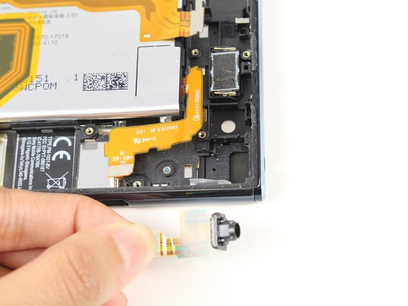

  23. Sony Xperia XZ Premium Headphone Jack Replacement, Headphone Jack: crwdns2935265:023crwdnd2935265:01crwdnd2935265:01crwdne2935265:0
    • Insert the spudger in the gap to the bottom of the headphone jack.
  24. Sony Xperia XZ Premium Headphone Jack Replacement: crwdns2935265:024crwdnd2935265:01crwdnd2935265:02crwdne2935265:0 Sony Xperia XZ Premium Headphone Jack Replacement: crwdns2935265:024crwdnd2935265:02crwdnd2935265:02crwdne2935265:0
    • Gently extract the headphone jack by pulling the orange tab with your fingers.
