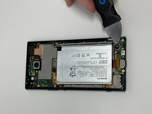

  17. Sony Xperia XA2 Ultra LCD Screen Replacement, Vibration Motor: crwdns2935265:017crwdnd2935265:01crwdnd2935265:02crwdne2935265:0 Sony Xperia XA2 Ultra LCD Screen Replacement, Vibration Motor: crwdns2935265:017crwdnd2935265:02crwdnd2935265:02crwdne2935265:0
    • Using the tweezers, pry underneath the vibration motor and pull from its place.
    • There is an adhesive underneath it so removing it may take a bit of work.

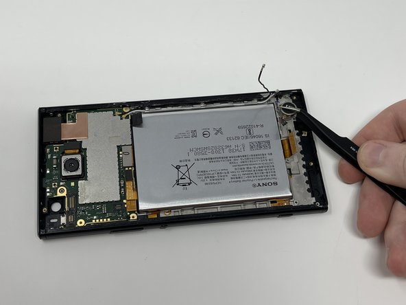

  21. Sony Xperia XA2 Ultra LCD Screen Replacement, Battery: crwdns2935265:021crwdnd2935265:01crwdnd2935265:01crwdne2935265:0
    • Grab and twist the black battery tab with a pair of precision tweezers.
    • This will remove the adhesive that is attached to the battery.
    • Do this again with the black tab under the power button flex cable.
  22. Sony Xperia XA2 Ultra LCD Screen Replacement: crwdns2935265:022crwdnd2935265:01crwdnd2935265:02crwdne2935265:0 Sony Xperia XA2 Ultra LCD Screen Replacement: crwdns2935265:022crwdnd2935265:02crwdnd2935265:02crwdne2935265:0
    • With the iFixit opening tool, remove the battery.

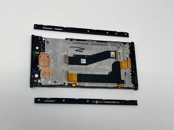

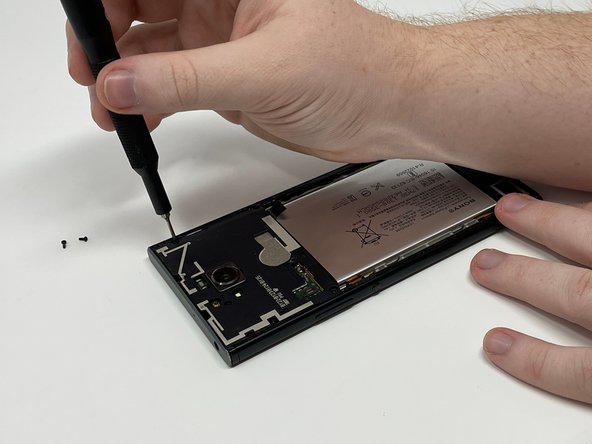

  24. Sony Xperia XA2 Ultra LCD Screen Replacement: crwdns2935265:024crwdnd2935265:01crwdnd2935265:02crwdne2935265:0 Sony Xperia XA2 Ultra LCD Screen Replacement: crwdns2935265:024crwdnd2935265:02crwdnd2935265:02crwdne2935265:0
    • Remove the six 3 mm T5 Torx screws.
    • The sides of the phone should fall off once the screws are out.

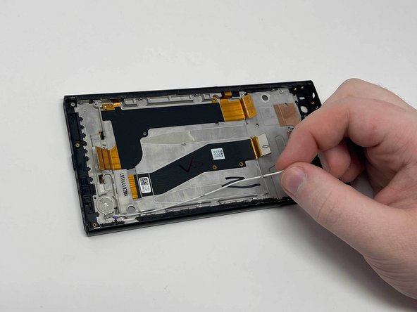

  25. Sony Xperia XA2 Ultra LCD Screen Replacement: crwdns2935265:025crwdnd2935265:01crwdnd2935265:01crwdne2935265:0
    • Pull up the flex tape so it is loose.

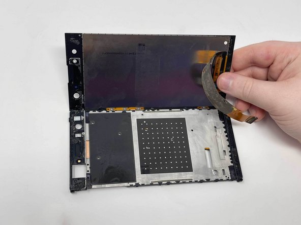

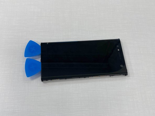

  26. Sony Xperia XA2 Ultra LCD Screen Replacement: crwdns2935265:026crwdnd2935265:01crwdnd2935265:02crwdne2935265:0 Sony Xperia XA2 Ultra LCD Screen Replacement: crwdns2935265:026crwdnd2935265:02crwdnd2935265:02crwdne2935265:0
    • With your heat gun, heat the edges of the phone for about a minute. Using the iFixit opening picks, pry underneath the screen.
    • If you are having trouble, the iFixit opening tool may help gain leverage.
    • The phone will become hot to the touch. Use gloves or a towel to touch the phone.
  27. Sony Xperia XA2 Ultra LCD Screen Replacement: crwdns2935265:027crwdnd2935265:01crwdnd2935265:03crwdne2935265:0 Sony Xperia XA2 Ultra LCD Screen Replacement: crwdns2935265:027crwdnd2935265:02crwdnd2935265:03crwdne2935265:0 Sony Xperia XA2 Ultra LCD Screen Replacement: crwdns2935265:027crwdnd2935265:03crwdnd2935265:03crwdne2935265:0
    • Take the picks and run them around the screen, removing the screen from the adhesive.
    • Slowly lift and remove the screen.
