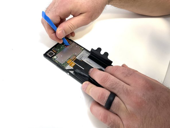

      • Use a plastic opening tool to lift the battery connector.
      • Lift the flaps on both sides of the battery.

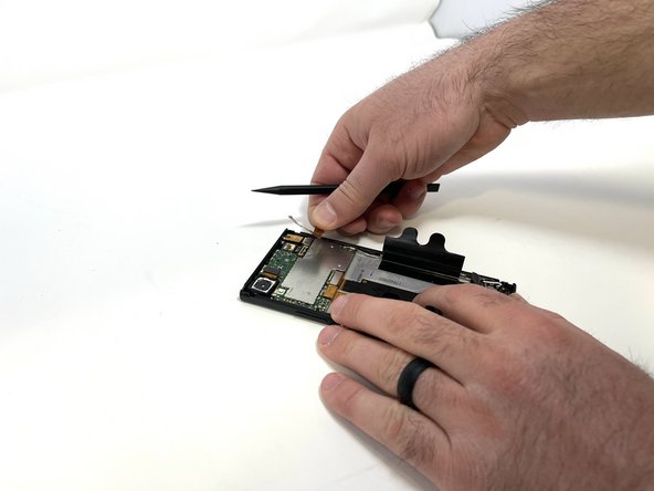

    1. Sony Xperia XA1 Screen Replacement, USB-C Module: crwdns2935265:06crwdnd2935265:01crwdnd2935265:03crwdne2935265:0 Sony Xperia XA1 Screen Replacement, USB-C Module: crwdns2935265:06crwdnd2935265:02crwdnd2935265:03crwdne2935265:0 Sony Xperia XA1 Screen Replacement, USB-C Module: crwdns2935265:06crwdnd2935265:03crwdnd2935265:03crwdne2935265:0

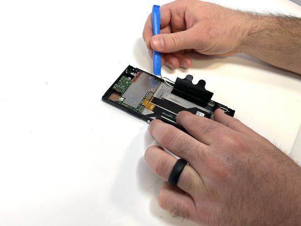

      • Locate the connecting cable and use a spudger or iFixit Opening Tool to remove the connector.
      • Disconnect the wifi/Bluetooth antenna wire, located at the top right of the USB-C charger board.

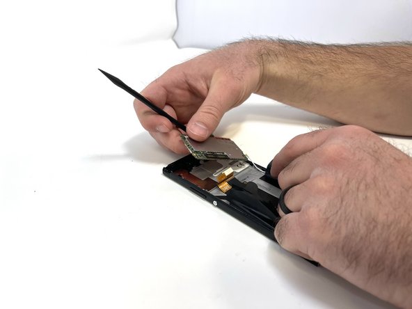

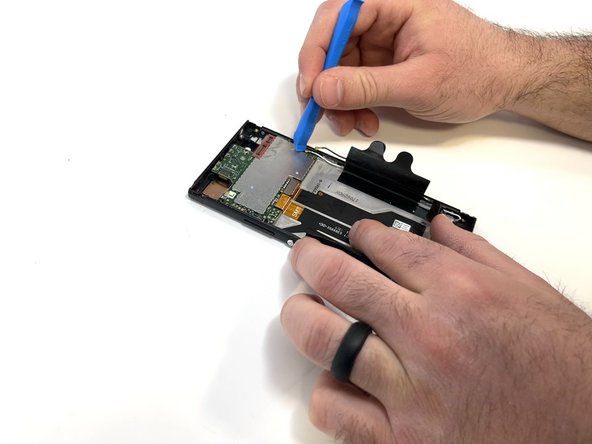

    2. Sony Xperia XA1 Screen Replacement: crwdns2935265:07crwdnd2935265:01crwdnd2935265:03crwdne2935265:0 Sony Xperia XA1 Screen Replacement: crwdns2935265:07crwdnd2935265:02crwdnd2935265:03crwdne2935265:0 Sony Xperia XA1 Screen Replacement: crwdns2935265:07crwdnd2935265:03crwdnd2935265:03crwdne2935265:0
      • After removing the connector and antennas, you are able to pry the USB-C board using a plastic spudger.
      • Be cautious, little effort is required to lift up the board, if too much force is applied this could damage the board.

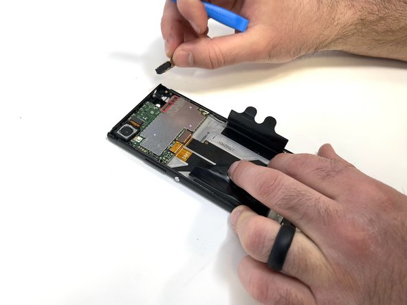

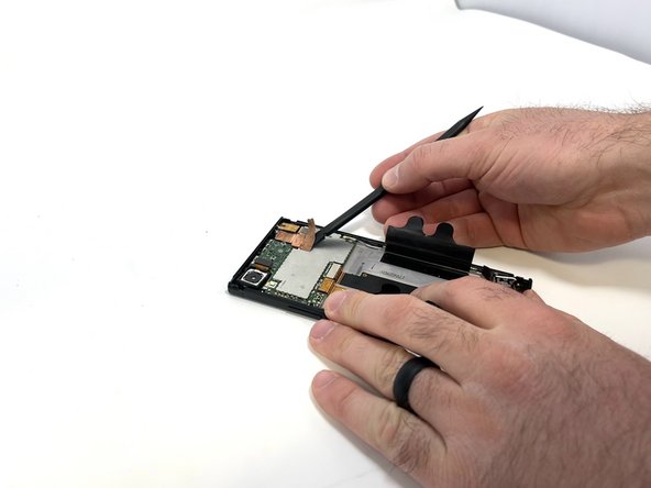

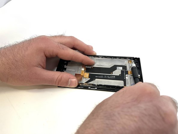

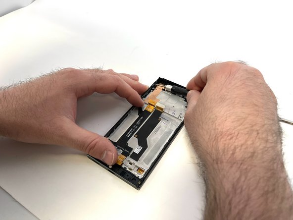

    1. Sony Xperia XA1 Screen Replacement, Screen: crwdns2935265:08crwdnd2935265:01crwdnd2935265:03crwdne2935265:0 Sony Xperia XA1 Screen Replacement, Screen: crwdns2935265:08crwdnd2935265:02crwdnd2935265:03crwdne2935265:0 Sony Xperia XA1 Screen Replacement, Screen: crwdns2935265:08crwdnd2935265:03crwdnd2935265:03crwdne2935265:0

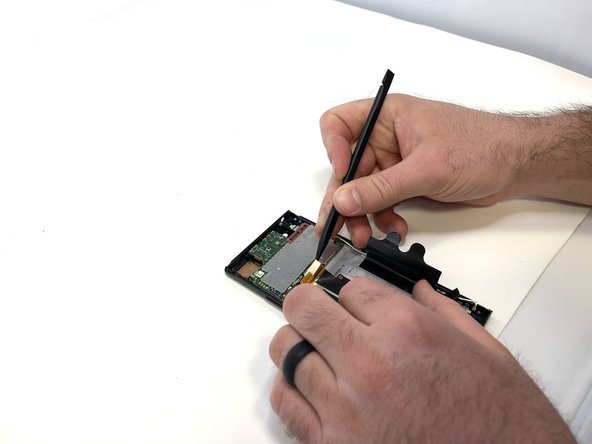

      • Using a spudger, carefully remove the thin copper piece attached to the motherboard.
      • This part is very easy to damage and can not be reused if damaged too much.

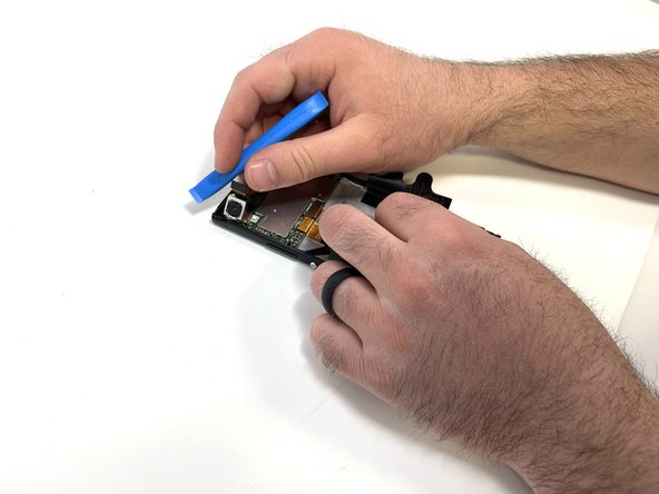

    2. Sony Xperia XA1 Screen Replacement: crwdns2935265:09crwdnd2935265:01crwdnd2935265:03crwdne2935265:0 Sony Xperia XA1 Screen Replacement: crwdns2935265:09crwdnd2935265:02crwdnd2935265:03crwdne2935265:0 Sony Xperia XA1 Screen Replacement: crwdns2935265:09crwdnd2935265:03crwdnd2935265:03crwdne2935265:0

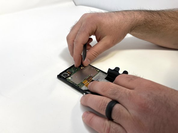

      • Carefully remove the front-facing camera with a spudger or your fingers.

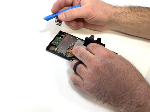

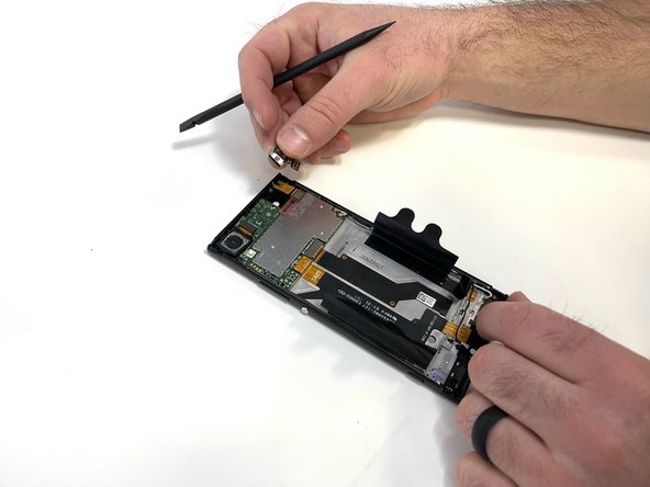

    4. Sony Xperia XA1 Screen Replacement: crwdns2935265:011crwdnd2935265:01crwdnd2935265:03crwdne2935265:0 Sony Xperia XA1 Screen Replacement: crwdns2935265:011crwdnd2935265:02crwdnd2935265:03crwdne2935265:0 Sony Xperia XA1 Screen Replacement: crwdns2935265:011crwdnd2935265:03crwdnd2935265:03crwdne2935265:0
      • Disconnect the camera using an iFixit opening tool and remove it with your fingers.

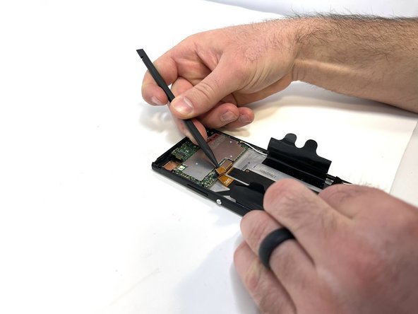

      • Using a spudger, remove the two connector tabs attached to the motherboard

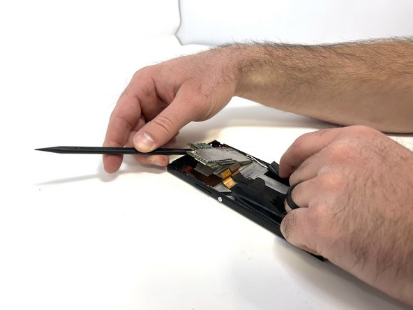

    7. Sony Xperia XA1 Screen Replacement: crwdns2935265:014crwdnd2935265:01crwdnd2935265:03crwdne2935265:0 Sony Xperia XA1 Screen Replacement: crwdns2935265:014crwdnd2935265:02crwdnd2935265:03crwdne2935265:0 Sony Xperia XA1 Screen Replacement: crwdns2935265:014crwdnd2935265:03crwdnd2935265:03crwdne2935265:0
      • Remove the single 3mm screw from the motherboard using a Phillips #000 bit.
      • Use a spudger to gently pry the motherboard free.

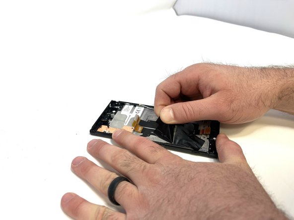

    8. Sony Xperia XA1 Screen Replacement: crwdns2935265:015crwdnd2935265:01crwdnd2935265:03crwdne2935265:0 Sony Xperia XA1 Screen Replacement: crwdns2935265:015crwdnd2935265:02crwdnd2935265:03crwdne2935265:0 Sony Xperia XA1 Screen Replacement: crwdns2935265:015crwdnd2935265:03crwdnd2935265:03crwdne2935265:0
      • Peel the plastic battery tabs free.

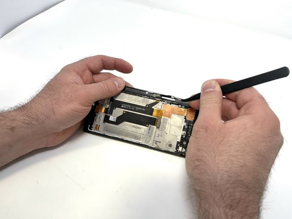

      • Using a pair of angled tweezers, carefully remove the earpiece.
      • The ear piece is attached using a sticky adhesive

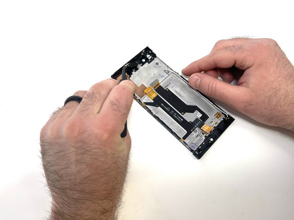

      • Using a pair of angled tweezers, carefully remove the small metal bracket from the top left side of the phone.

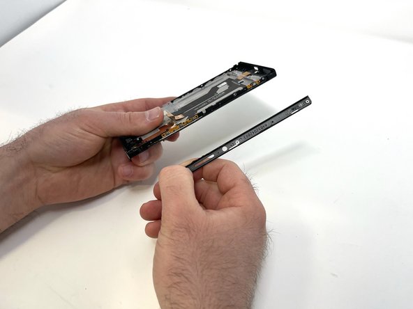

    11. Sony Xperia XA1 Screen Replacement: crwdns2935265:018crwdnd2935265:01crwdnd2935265:03crwdne2935265:0 Sony Xperia XA1 Screen Replacement: crwdns2935265:018crwdnd2935265:02crwdnd2935265:03crwdne2935265:0 Sony Xperia XA1 Screen Replacement: crwdns2935265:018crwdnd2935265:03crwdnd2935265:03crwdne2935265:0
      • Remove the four 3mm silver screws located on the left side of the case using a Phillips #000 bit.
      • Once the screws are removed, unfold the side piece.

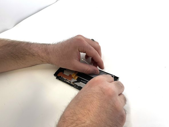

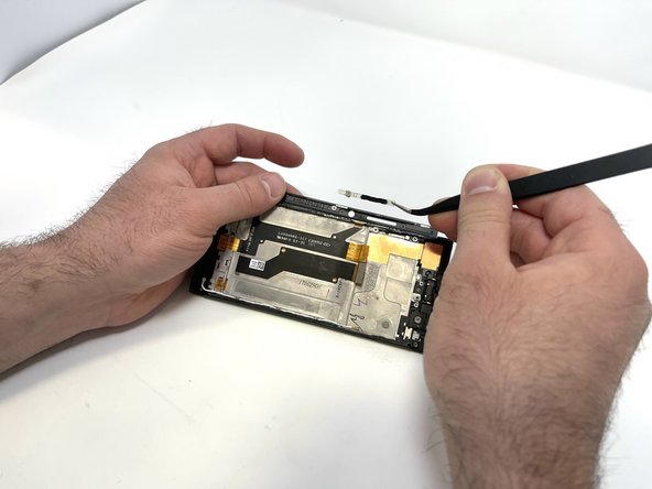

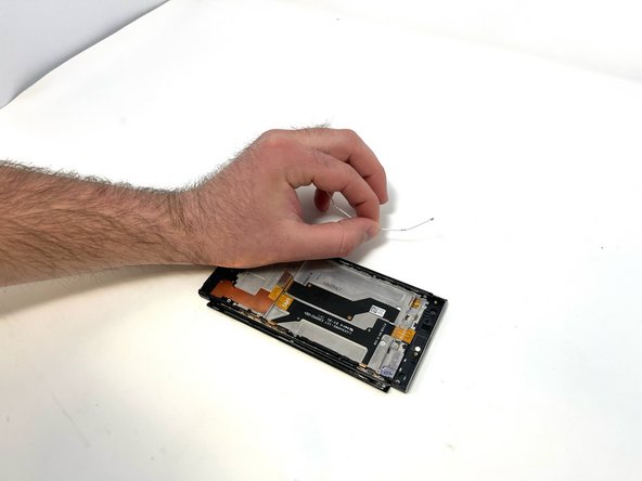

    13. Sony Xperia XA1 Screen Replacement: crwdns2935265:020crwdnd2935265:01crwdnd2935265:03crwdne2935265:0 Sony Xperia XA1 Screen Replacement: crwdns2935265:020crwdnd2935265:02crwdnd2935265:03crwdne2935265:0 Sony Xperia XA1 Screen Replacement: crwdns2935265:020crwdnd2935265:03crwdnd2935265:03crwdne2935265:0
      • Carefully remove the antennas.
      • Use a pair of tweezers if needed.

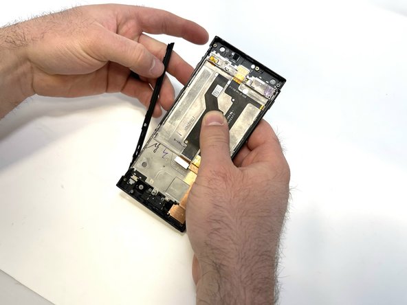

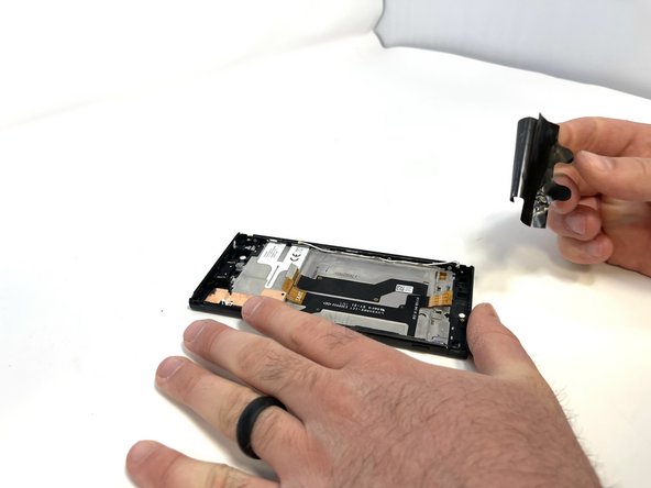

    14. Sony Xperia XA1 Screen Replacement: crwdns2935265:021crwdnd2935265:01crwdnd2935265:03crwdne2935265:0 Sony Xperia XA1 Screen Replacement: crwdns2935265:021crwdnd2935265:02crwdnd2935265:03crwdne2935265:0 Sony Xperia XA1 Screen Replacement: crwdns2935265:021crwdnd2935265:03crwdnd2935265:03crwdne2935265:0
      • Remove the four 3mm silver screws from the right side of the phone using a Phillips #000 bit.
      • Once unfolded, peel the side piece from the phone, separating the glue that holds the two pieces together.

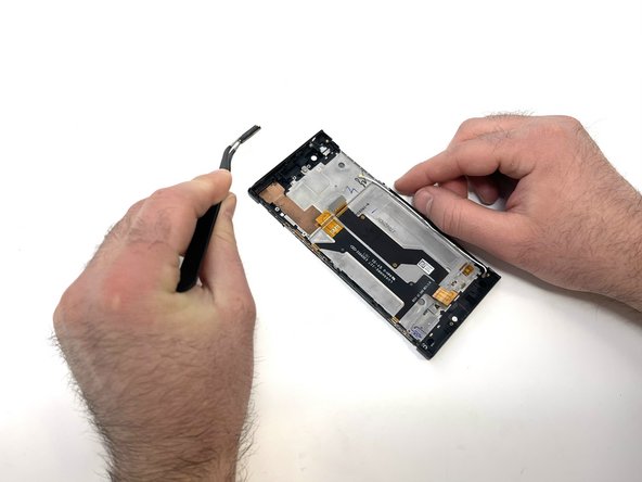

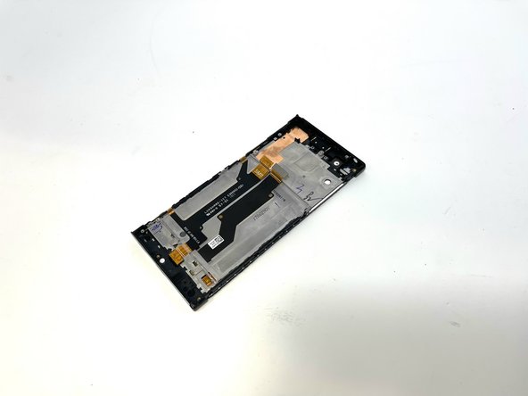

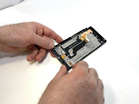

    15. Sony Xperia XA1 Screen Replacement: crwdns2935265:022crwdnd2935265:01crwdnd2935265:03crwdne2935265:0 Sony Xperia XA1 Screen Replacement: crwdns2935265:022crwdnd2935265:02crwdnd2935265:03crwdne2935265:0 Sony Xperia XA1 Screen Replacement: crwdns2935265:022crwdnd2935265:03crwdnd2935265:03crwdne2935265:0
      • Remove the other side in the same manner.
      • All removeable components should be free, ready to be installed into your replacement screen.
