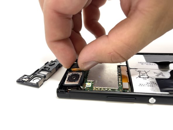

  2. Sony Xperia XA1 Rear Camera Replacement, Rear Camera: crwdns2935265:02crwdnd2935265:01crwdnd2935265:03crwdne2935265:0 Sony Xperia XA1 Rear Camera Replacement, Rear Camera: crwdns2935265:02crwdnd2935265:02crwdnd2935265:03crwdne2935265:0 Sony Xperia XA1 Rear Camera Replacement, Rear Camera: crwdns2935265:02crwdnd2935265:03crwdnd2935265:03crwdne2935265:0
    • Use a Phillips #000 screwdriver to remove the three 3 mm screws near the top of the phone.
    • Use a spudger to gently pry the three tabs at the top of the phone.
  3. Sony Xperia XA1 Rear Camera Replacement: crwdns2935265:03crwdnd2935265:01crwdnd2935265:03crwdne2935265:0 Sony Xperia XA1 Rear Camera Replacement: crwdns2935265:03crwdnd2935265:02crwdnd2935265:03crwdne2935265:0 Sony Xperia XA1 Rear Camera Replacement: crwdns2935265:03crwdnd2935265:03crwdnd2935265:03crwdne2935265:0
    • Gently pry at the tabs until the cover comes free and is able to be removed.
    • Pull the piece up and set it aside. No cables are attached to the back.

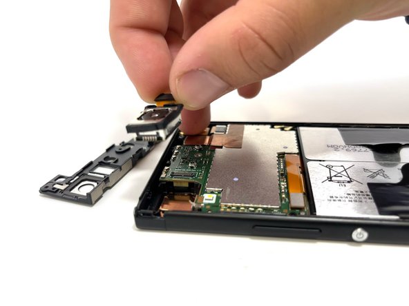

  4. Sony Xperia XA1 Rear Camera Replacement: crwdns2935265:04crwdnd2935265:01crwdnd2935265:03crwdne2935265:0 Sony Xperia XA1 Rear Camera Replacement: crwdns2935265:04crwdnd2935265:02crwdnd2935265:03crwdne2935265:0 Sony Xperia XA1 Rear Camera Replacement: crwdns2935265:04crwdnd2935265:03crwdnd2935265:03crwdne2935265:0
    • Use an opening tool to release the back camera connector.
    • Gently pull the camera connector up to remove it.
    • Exercise caution when handling the rubber holder around the lens, as it can pop off easily.
