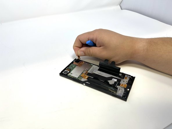

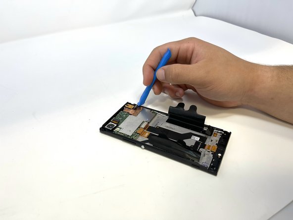

  4. Sony Xperia XA1 Audio Jack Replacement: crwdns2935265:04crwdnd2935265:01crwdnd2935265:03crwdne2935265:0 Sony Xperia XA1 Audio Jack Replacement: crwdns2935265:04crwdnd2935265:02crwdnd2935265:03crwdne2935265:0 Sony Xperia XA1 Audio Jack Replacement: crwdns2935265:04crwdnd2935265:03crwdnd2935265:03crwdne2935265:0
    • Use the Phillips #000 Screwdriver to remove the 3 mm screw to the left of the audio jack component.
    • Use an opening tool to lift the audio jack connector.
    • Pinch the connector and remove the audio jack.
