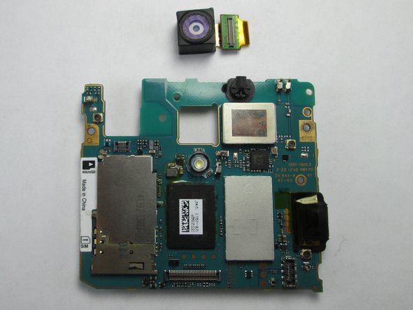

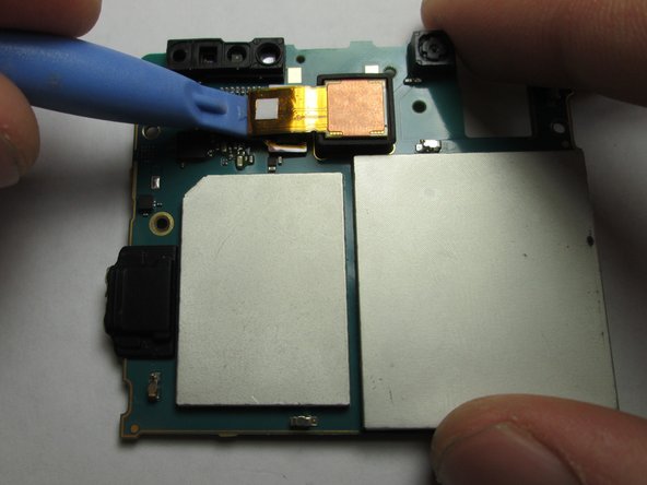

  7. Sony Xperia TL Camera Replacement, Camera: crwdns2935265:07crwdnd2935265:01crwdnd2935265:03crwdne2935265:0 Sony Xperia TL Camera Replacement, Camera: crwdns2935265:07crwdnd2935265:02crwdnd2935265:03crwdne2935265:0 Sony Xperia TL Camera Replacement, Camera: crwdns2935265:07crwdnd2935265:03crwdnd2935265:03crwdne2935265:0
    • 'Use the plastic opening tool to detach the camera from the motherboard.'
    • The camera attachment is on the back of the motherboard.
