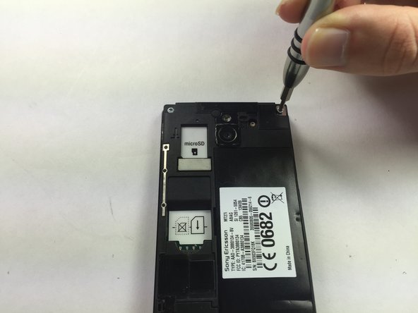

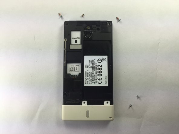

    • Remove the five screws as shown on the phone by using 26 Bit Kit.
    • Use a T6 screwdriver bit to remove top two screws.
    • Use a J000 screwdriver bit to remove the bottom two screws.

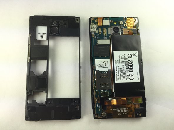

    • Use a T3 screwdriver bit to remove the middle screw (close to camera).

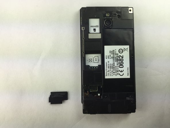

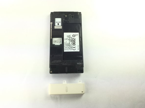

    • Use plastic opening tool to remove the bottom white cover as shown.
  5. Sony Xperia Sola Touch Screen Replacement: crwdns2935265:05crwdnd2935265:01crwdnd2935265:02crwdne2935265:0 Sony Xperia Sola Touch Screen Replacement: crwdns2935265:05crwdnd2935265:02crwdnd2935265:02crwdne2935265:0

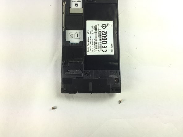

    • There are two additional screws under the bottom white cover as shown.
    • Use T3 drivers to remove two additional screws as shown.

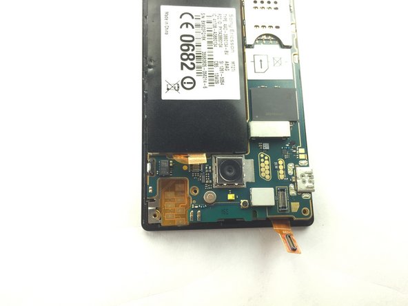

  6. Sony Xperia Sola Touch Screen Replacement: crwdns2935265:06crwdnd2935265:01crwdnd2935265:03crwdne2935265:0 Sony Xperia Sola Touch Screen Replacement: crwdns2935265:06crwdnd2935265:02crwdnd2935265:03crwdne2935265:0 Sony Xperia Sola Touch Screen Replacement: crwdns2935265:06crwdnd2935265:03crwdnd2935265:03crwdne2935265:0

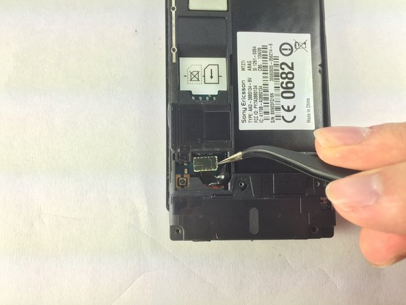

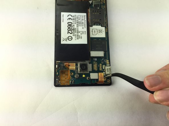

    • Using plastic opening tool, lift to remove the small black cover on the bottom left of phone as shown.
    • Then, using tweezers to lift the connector straight up to disconnect the battery's circuit as shown.

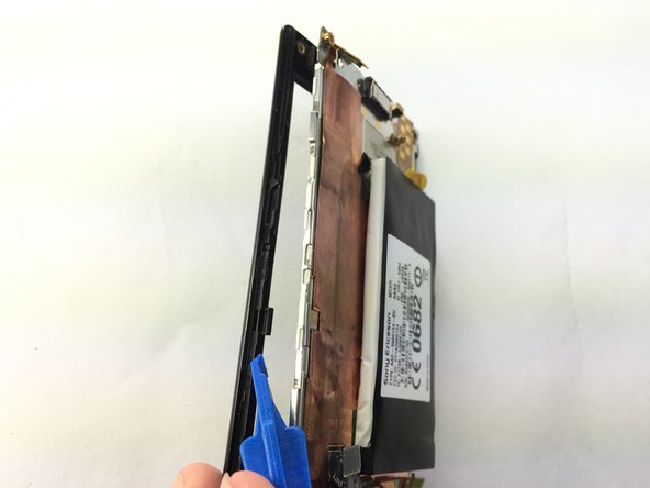

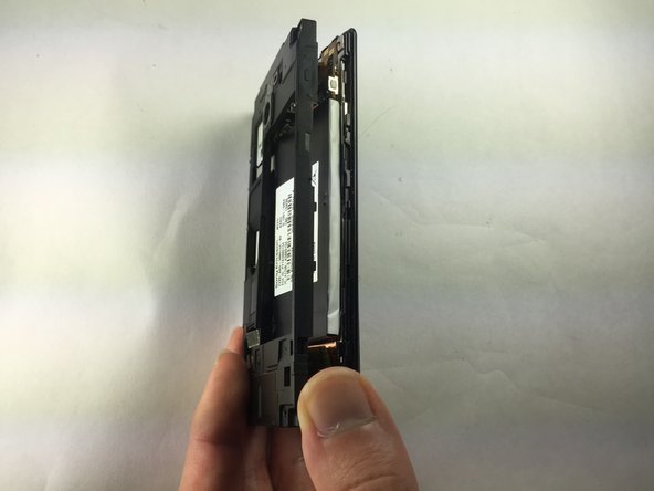

    • Turn the phone onto its side and insert a flat object and gently remove cover, using plastic opening tool as shown.

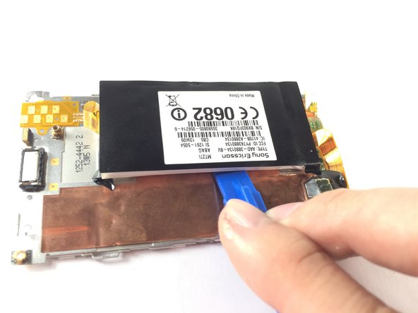

  10. Sony Xperia Sola Touch Screen Replacement: crwdns2935265:010crwdnd2935265:01crwdnd2935265:02crwdne2935265:0 Sony Xperia Sola Touch Screen Replacement: crwdns2935265:010crwdnd2935265:02crwdnd2935265:02crwdne2935265:0

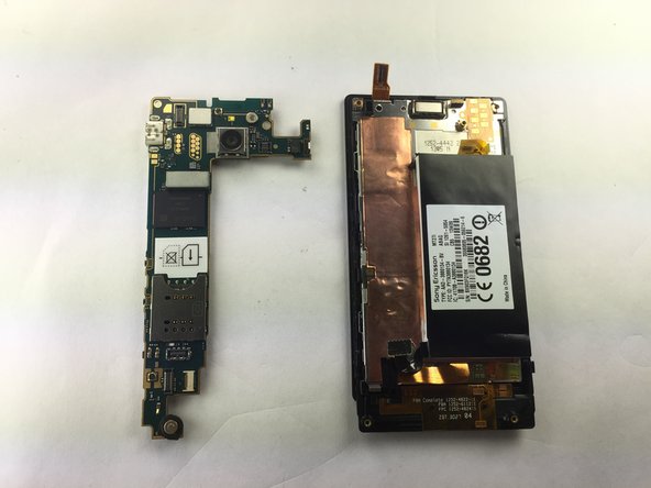

    • After removing all connectors, Use the plastic opening tool to slide it under the top left of the board then lift the board straight up.

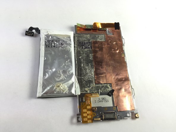

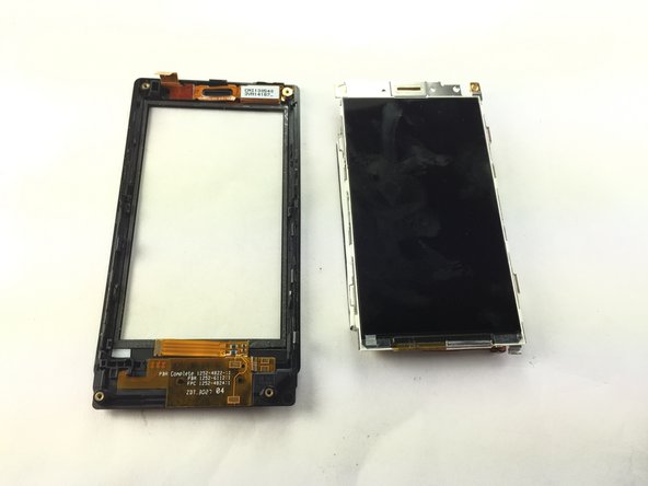

    • Separate the screen from the touch screen sensor, use the spudger to do this job.
    • The left piece is the plastic screen.
    • The right piece is the touch screen sensor that you are looking to replace.
  12. Sony Xperia Sola Touch Screen Replacement: crwdns2935265:012crwdnd2935265:01crwdnd2935265:03crwdne2935265:0 Sony Xperia Sola Touch Screen Replacement: crwdns2935265:012crwdnd2935265:02crwdnd2935265:03crwdne2935265:0 Sony Xperia Sola Touch Screen Replacement: crwdns2935265:012crwdnd2935265:03crwdnd2935265:03crwdne2935265:0
    • Flip the touch screen sensor over and remove the battery from the back of it.
    • The battery might be glued on so some force might be needed.
