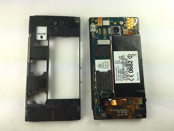

    • Push the back cover as shown, then lift the cover off.

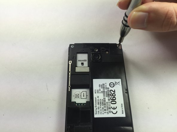

  3. Sony Xperia Sola Speaker Replacement: crwdns2935265:03crwdnd2935265:01crwdnd2935265:03crwdne2935265:0 Sony Xperia Sola Speaker Replacement: crwdns2935265:03crwdnd2935265:02crwdnd2935265:03crwdne2935265:0 Sony Xperia Sola Speaker Replacement: crwdns2935265:03crwdnd2935265:03crwdnd2935265:03crwdne2935265:0

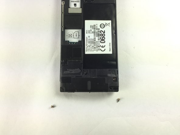

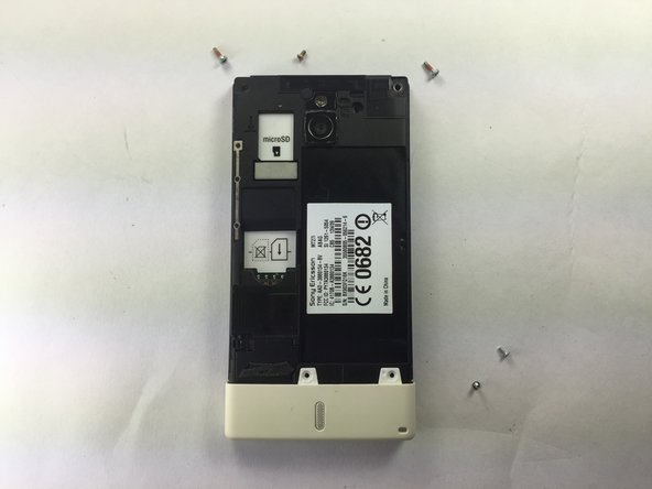

    • Remove the five screws as shown on the phone by using 26 Bit Kit.
    • Use a T6 screwdriver bit to remove top two screws.
    • Use a J000 screwdriver bit to remove the bottom two screws.
    • Use a T3 screwdriver bit to remove the middle screw (close to camera).

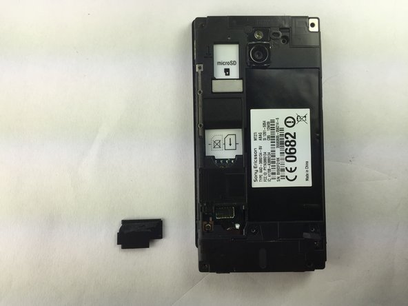

  4. Sony Xperia Sola Speaker Replacement: crwdns2935265:04crwdnd2935265:01crwdnd2935265:02crwdne2935265:0 Sony Xperia Sola Speaker Replacement: crwdns2935265:04crwdnd2935265:02crwdnd2935265:02crwdne2935265:0

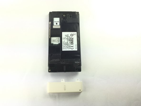

    • Use plastic opening tool to remove the bottom white cover as shown.

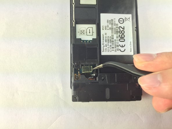

  6. Sony Xperia Sola Speaker Replacement: crwdns2935265:06crwdnd2935265:01crwdnd2935265:03crwdne2935265:0 Sony Xperia Sola Speaker Replacement: crwdns2935265:06crwdnd2935265:02crwdnd2935265:03crwdne2935265:0 Sony Xperia Sola Speaker Replacement: crwdns2935265:06crwdnd2935265:03crwdnd2935265:03crwdne2935265:0
    • Using plastic opening tool, lift to remove the small black cover on the bottom left of phone as shown.
    • Then, using tweezers to lift the connector straight up to disconnect the battery's circuit as shown.

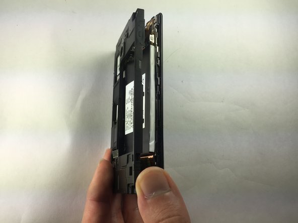

    • Turn the phone onto its side and insert a flat object and gently remove cover, using plastic opening tool as shown.

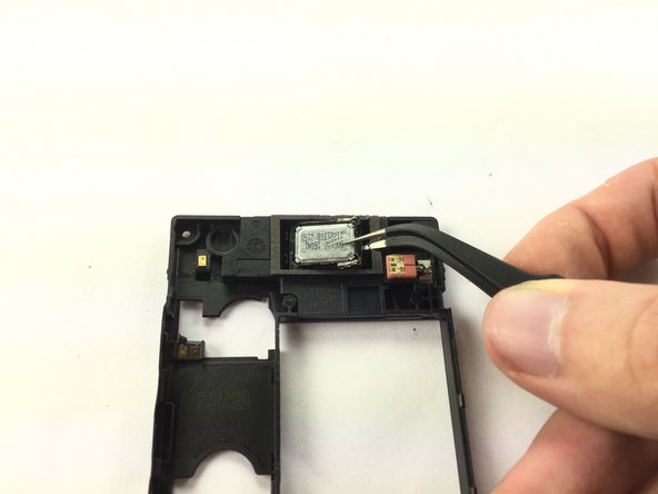

  8. Sony Xperia Sola Speaker Replacement: crwdns2935265:08crwdnd2935265:01crwdnd2935265:03crwdne2935265:0 Sony Xperia Sola Speaker Replacement: crwdns2935265:08crwdnd2935265:02crwdnd2935265:03crwdne2935265:0 Sony Xperia Sola Speaker Replacement: crwdns2935265:08crwdnd2935265:03crwdnd2935265:03crwdne2935265:0

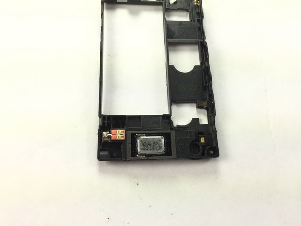

    • Flip over the black back cover and locate the speaker phone at the bottom, then use the tweezers to remove the speaker. It is glued to the back cover so a little force will be needed.
