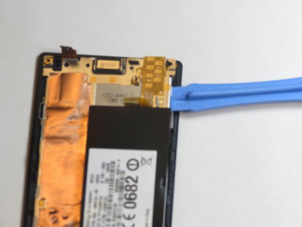

  10. Sony Xperia Sola LCD Screen Replacement, Remove the motherboard.: crwdns2935265:010crwdnd2935265:01crwdnd2935265:01crwdne2935265:0
    • Use the spudger and slide it under the top left of the board then lift the board straight up. The board should come up very easily.

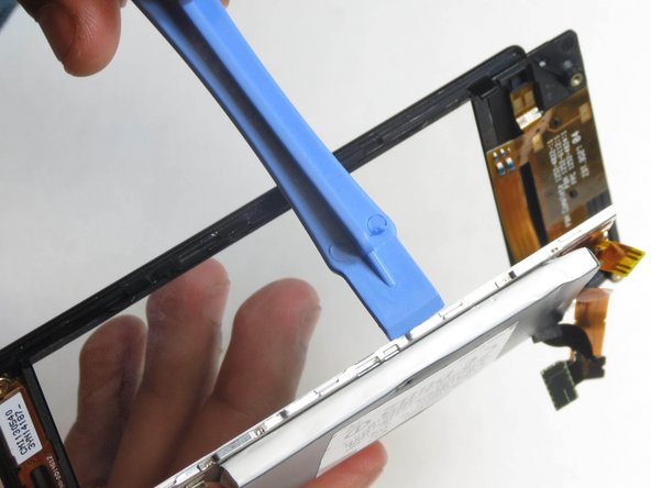

  11. Sony Xperia Sola LCD Screen Replacement, Remove the LCD screen.: crwdns2935265:011crwdnd2935265:01crwdnd2935265:03crwdne2935265:0 Sony Xperia Sola LCD Screen Replacement, Remove the LCD screen.: crwdns2935265:011crwdnd2935265:02crwdnd2935265:03crwdne2935265:0 Sony Xperia Sola LCD Screen Replacement, Remove the LCD screen.: crwdns2935265:011crwdnd2935265:03crwdnd2935265:03crwdne2935265:0
    • Use either the plastic opener or the spudger to slid in the side. It will go in between the LCD screen and the spot you pulled the board off of.
