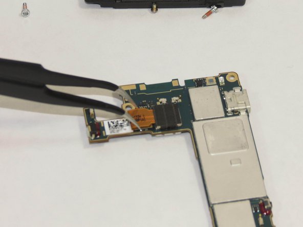

    1. Sony Xperia Sola Camera Module Replacement, Place the board as shown.: crwdns2935265:011crwdnd2935265:01crwdnd2935265:01crwdne2935265:0
      • This will ensure easy removal of the camera module.

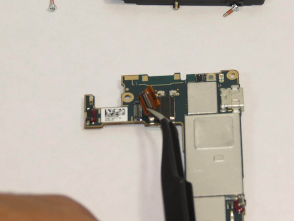

    2. Sony Xperia Sola Camera Module Replacement, Remove the camera's power.: crwdns2935265:012crwdnd2935265:01crwdnd2935265:03crwdne2935265:0 Sony Xperia Sola Camera Module Replacement, Remove the camera's power.: crwdns2935265:012crwdnd2935265:02crwdnd2935265:03crwdne2935265:0 Sony Xperia Sola Camera Module Replacement, Remove the camera's power.: crwdns2935265:012crwdnd2935265:03crwdnd2935265:03crwdne2935265:0
      • Using the tweezers remove the camera from the power source.
    3. Sony Xperia Sola Camera Module Replacement, Remove the camera module.: crwdns2935265:013crwdnd2935265:01crwdnd2935265:01crwdne2935265:0
      • Pick up board and remove camera module. The module should seem to just pop out.
