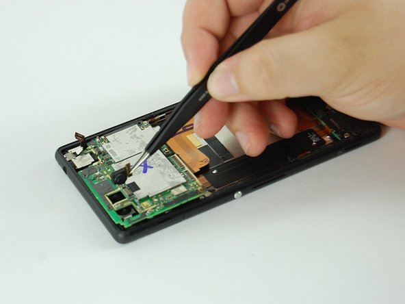

  9. Sony Xperia M4 Aqua Front Camera Replacement, Rear Camera: crwdns2935265:09crwdnd2935265:01crwdnd2935265:01crwdne2935265:0
    • Remove the four hex head 3mm screws at each corner of the motherboard with a screwdriver.
  10. Sony Xperia M4 Aqua Front Camera Replacement: crwdns2935265:010crwdnd2935265:01crwdnd2935265:02crwdne2935265:0 Sony Xperia M4 Aqua Front Camera Replacement: crwdns2935265:010crwdnd2935265:02crwdnd2935265:02crwdne2935265:0
    • Remove three pieces of the securing bracket using tweezers
  11. Sony Xperia M4 Aqua Front Camera Replacement: crwdns2935265:011crwdnd2935265:01crwdnd2935265:02crwdne2935265:0 Sony Xperia M4 Aqua Front Camera Replacement: crwdns2935265:011crwdnd2935265:02crwdnd2935265:02crwdne2935265:0
    • Detach the rear camera connector from the front of the motherboard.
    • Remove the rear camera with your fingers or tweezers.
  12. Sony Xperia M4 Aqua Front Camera Replacement, Front Camera: crwdns2935265:012crwdnd2935265:01crwdnd2935265:01crwdne2935265:0
    • Release all connectors connecting to the motherboard.
    • Pry the motherboard up from the left side with the plastic pry tool and remove it.
    • Be very careful as the motherboard is tightly bound.
  13. Sony Xperia M4 Aqua Front Camera Replacement: crwdns2935265:013crwdnd2935265:01crwdnd2935265:01crwdne2935265:0
    • With your fingers, detach front camera connector from the back of motherboard.
    • Remove the front camera.
