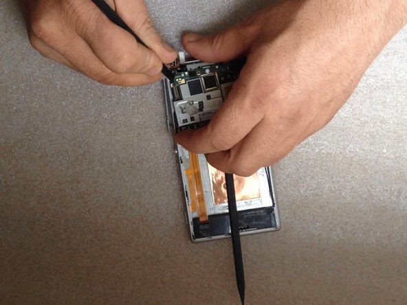

      • Disconnect the LCD Display flex cable located on the other side of the board.
      • Put a plastic tool between the motherboard and the frame.
    4. Sony Xperia M2 Touchscreen Replacement: crwdns2935265:06crwdnd2935265:01crwdnd2935265:03crwdne2935265:0 Sony Xperia M2 Touchscreen Replacement: crwdns2935265:06crwdnd2935265:02crwdnd2935265:03crwdne2935265:0 Sony Xperia M2 Touchscreen Replacement: crwdns2935265:06crwdnd2935265:03crwdnd2935265:03crwdne2935265:0
      • Make sure to only use plastic tools, so you don't damage the board.
      • Move the left side of the board downward.
      • Take the left side out of the frame.
      • Take out the whole motherboard.

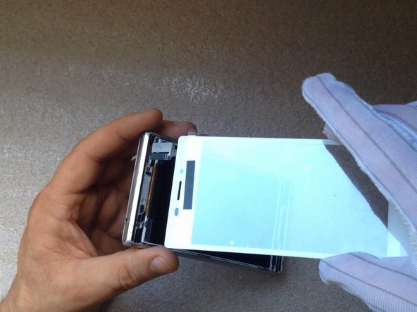

    1. Sony Xperia M2 Touchscreen Replacement, LCD Display, Touchscreen / Glass / Digitizer: crwdns2935265:07crwdnd2935265:01crwdnd2935265:03crwdne2935265:0 Sony Xperia M2 Touchscreen Replacement, LCD Display, Touchscreen / Glass / Digitizer: crwdns2935265:07crwdnd2935265:02crwdnd2935265:03crwdne2935265:0 Sony Xperia M2 Touchscreen Replacement, LCD Display, Touchscreen / Glass / Digitizer: crwdns2935265:07crwdnd2935265:03crwdnd2935265:03crwdne2935265:0

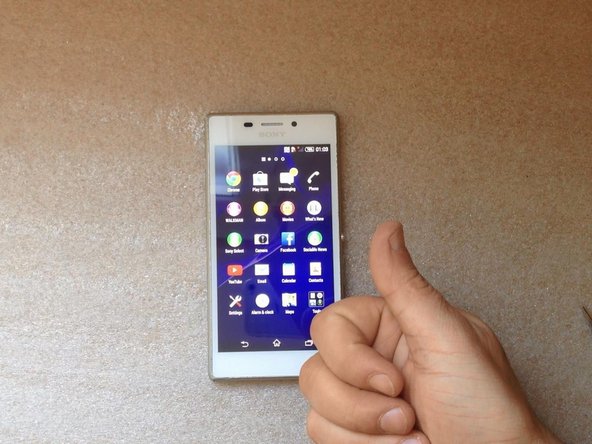

      • Let's first test the new spare parts.
    2. Sony Xperia M2 Touchscreen Replacement: crwdns2935265:08crwdnd2935265:01crwdnd2935265:03crwdne2935265:0 Sony Xperia M2 Touchscreen Replacement: crwdns2935265:08crwdnd2935265:02crwdnd2935265:03crwdne2935265:0 Sony Xperia M2 Touchscreen Replacement: crwdns2935265:08crwdnd2935265:03crwdnd2935265:03crwdne2935265:0

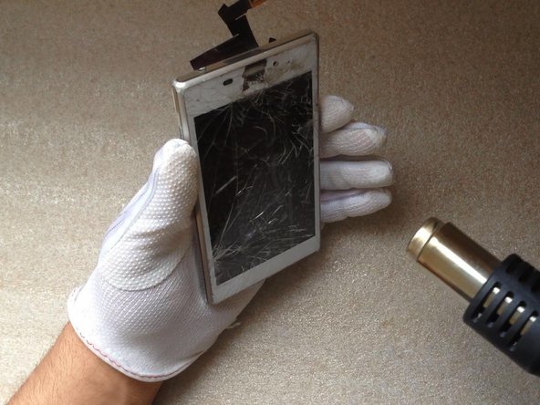

      • Use a scotch tape for the broken glass.
      • Unstuck the LCD Display flex cable from the Main frame.
      • Now preheat the glass before removing. This will soften the adhesive and will make separating more easy.
      • You can use a hairdryer.
    3. Sony Xperia M2 Touchscreen Replacement: crwdns2935265:09crwdnd2935265:01crwdnd2935265:03crwdne2935265:0 Sony Xperia M2 Touchscreen Replacement: crwdns2935265:09crwdnd2935265:02crwdnd2935265:03crwdne2935265:0 Sony Xperia M2 Touchscreen Replacement: crwdns2935265:09crwdnd2935265:03crwdnd2935265:03crwdne2935265:0

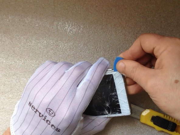

      • With a cutter, make a room for a plastic tool, then continue with separating the Touchscreen & LCD Display from the frame.
    4. Sony Xperia M2 Touchscreen Replacement: crwdns2935265:010crwdnd2935265:01crwdnd2935265:03crwdne2935265:0 Sony Xperia M2 Touchscreen Replacement: crwdns2935265:010crwdnd2935265:02crwdnd2935265:03crwdne2935265:0 Sony Xperia M2 Touchscreen Replacement: crwdns2935265:010crwdnd2935265:03crwdnd2935265:03crwdne2935265:0

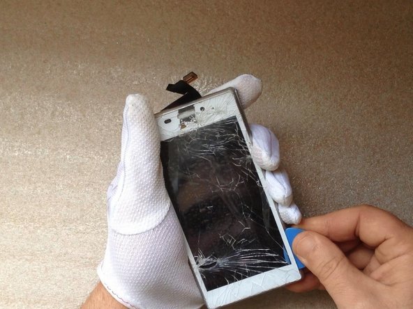

      • This is the Display Assembly.
      • The LCD Display and the Touchscreen are not firmly bonded, while some other other models.
    5. Sony Xperia M2 Touchscreen Replacement: crwdns2935265:011crwdnd2935265:01crwdnd2935265:03crwdne2935265:0 Sony Xperia M2 Touchscreen Replacement: crwdns2935265:011crwdnd2935265:02crwdnd2935265:03crwdne2935265:0 Sony Xperia M2 Touchscreen Replacement: crwdns2935265:011crwdnd2935265:03crwdnd2935265:03crwdne2935265:0
      • If your Touchscreen or LCD Display is OK, separate them carefully.
      • In our situation, both of them are broken.
    6. Sony Xperia M2 Touchscreen Replacement: crwdns2935265:012crwdnd2935265:01crwdnd2935265:03crwdne2935265:0 Sony Xperia M2 Touchscreen Replacement: crwdns2935265:012crwdnd2935265:02crwdnd2935265:03crwdne2935265:0 Sony Xperia M2 Touchscreen Replacement: crwdns2935265:012crwdnd2935265:03crwdnd2935265:03crwdne2935265:0

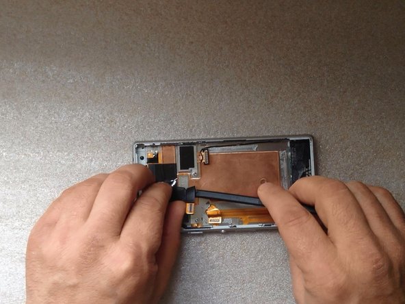

      • Clean the frame from the remains of tape.
      • Install the LCD Display and the flex cable on its correct place.
    7. Sony Xperia M2 Touchscreen Replacement: crwdns2935265:013crwdnd2935265:01crwdnd2935265:03crwdne2935265:0 Sony Xperia M2 Touchscreen Replacement: crwdns2935265:013crwdnd2935265:02crwdnd2935265:03crwdne2935265:0 Sony Xperia M2 Touchscreen Replacement: crwdns2935265:013crwdnd2935265:03crwdnd2935265:03crwdne2935265:0
      • We could not find adhesive sticker for this model, so We used universal adhesive tape 3M - 3 mm.
      • Don't forget to remove protectors from the LCD Display and from the inner side of the Touchscreen.
    8. Sony Xperia M2 Touchscreen Replacement: crwdns2935265:014crwdnd2935265:01crwdnd2935265:03crwdne2935265:0 Sony Xperia M2 Touchscreen Replacement: crwdns2935265:014crwdnd2935265:02crwdnd2935265:03crwdne2935265:0 Sony Xperia M2 Touchscreen Replacement: crwdns2935265:014crwdnd2935265:03crwdnd2935265:03crwdne2935265:0

I successfuly repaired my Phone. The only Problem i had was that i proke the LCD as i was trying to Open the Phone. So take care when you open the phone an be very carefull!
Thank you Ifixit for this guide!
Fabian - crwdns2934203:0crwdne2934203:0 crwdns2950251:0crwdne2950251:0
Followed Guide & completed without any errors. Also Step 2 "remove x4 screws" There's also x2 Screws on the board that needs removing.
Also The touch screen isn't exactly glued to the screen so does come of pretty easy but be very careful when using spudger to remove the glass as you could easily prod the touch screen. Apart from that thanks for the Guide it went well.
WILSON3000 - crwdns2934203:0crwdne2934203:0 crwdns2950251:0crwdne2950251:0
Hi there. Thanks for the leaflet with the links that I got with my purchase. Things went really well, except for one thing. Not sure if you can help, but it would be great if you can.
Everything is connected and assembled, although not bonded yet. The problem I have is the touch screen buttons at the bottom of the screen (return/back, home, task navigation) are completely unresponsive. Is there anything you could advice to help please.
It might be worth knowing that with the phone in landscape (rather than portrait) the buttons seem to work, maybe suggesting that there is something at the bottom of the screen that's not quite right.
Thank you in advance of any response.
spooksfacebook - crwdns2934203:0crwdne2934203:0 crwdns2950251:0crwdne2950251:0
bro you change whole part touch digitizer + lcd ???
shehroz - crwdns2934203:0crwdne2934203:0 crwdns2950251:0crwdne2950251:0
I changed the broken touchscreen today... with success, except that during the operation, I broke the LCD! (I did not read the comments first!!!) Indeed, the screen was broken in many parts and as I wanted to unpaste some of the rather small parts (1-2cm wide), they pressed on the screen and broke it. It is not visible when switched off, but I could check that some broken parts correspond to the shape of some shards of glass when I switched it on and realize that I broke it.
A comment that might be useful: when you assemble again the microphone part, extend maximally the door of the SIM and the microSD, otherwise you may have difficulties to place it back, and do not forget the connector of the proximity detector.
Good luck!
Nicohoho - crwdns2934203:0crwdne2934203:0 crwdns2950251:0crwdne2950251:0
