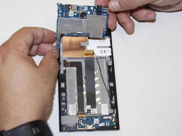

  5. Sony Xperia L2 LTE Rear Camera  Replacement, Motherboard: crwdns2935265:05crwdnd2935265:01crwdnd2935265:01crwdne2935265:0
    • Unclip circuit connectors from phone to motherboard.
  6. Sony Xperia L2 LTE Rear Camera  Replacement: crwdns2935265:06crwdnd2935265:01crwdnd2935265:03crwdne2935265:0 Sony Xperia L2 LTE Rear Camera  Replacement: crwdns2935265:06crwdnd2935265:02crwdnd2935265:03crwdne2935265:0 Sony Xperia L2 LTE Rear Camera  Replacement: crwdns2935265:06crwdnd2935265:03crwdnd2935265:03crwdne2935265:0
    • Use blue plastic opening tool to pry off the motherboard.

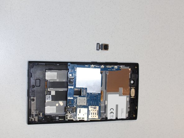

  7. Sony Xperia L2 LTE Rear Camera  Replacement, Rear Camera: crwdns2935265:07crwdnd2935265:01crwdnd2935265:02crwdne2935265:0 Sony Xperia L2 LTE Rear Camera  Replacement, Rear Camera: crwdns2935265:07crwdnd2935265:02crwdnd2935265:02crwdne2935265:0
    • Detach the rear camera from motherboard and remove it from the device.
