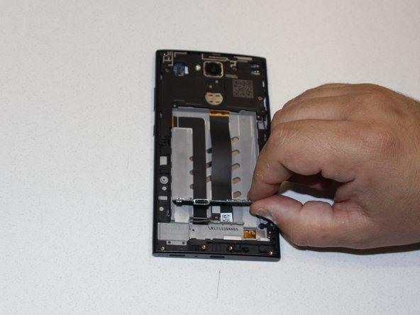

  5. Sony Xperia L2 LTE Charging Port Replacement, Charging Port: crwdns2935265:05crwdnd2935265:01crwdnd2935265:02crwdne2935265:0 Sony Xperia L2 LTE Charging Port Replacement, Charging Port: crwdns2935265:05crwdnd2935265:02crwdnd2935265:02crwdne2935265:0
    • Use a plastic opening tool to lift the charging port circuit board.
  6. Sony Xperia L2 LTE Charging Port Replacement: crwdns2935265:06crwdnd2935265:01crwdnd2935265:01crwdne2935265:0
    • Unhook the antenna from circuit board using a plastic opening tool and remove the charging port circuit board from the device.
