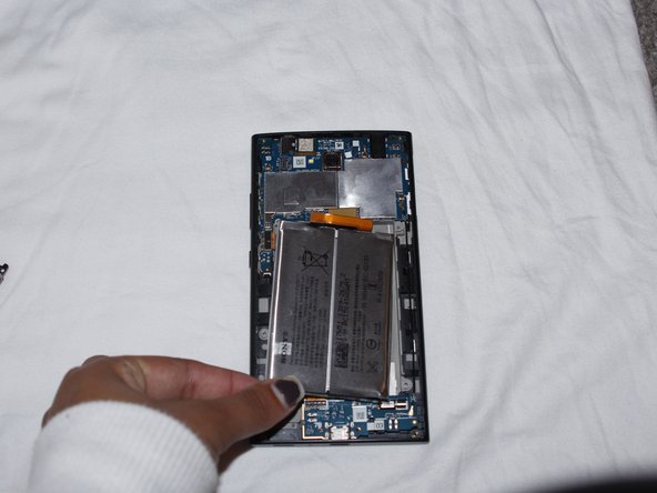

  4. Sony Xperia L2 LTE Battery Replacement: crwdns2935265:04crwdnd2935265:01crwdnd2935265:02crwdne2935265:0 Sony Xperia L2 LTE Battery Replacement: crwdns2935265:04crwdnd2935265:02crwdnd2935265:02crwdne2935265:0
    • Disconnect the battery cable from the motherboard.
    • Pry up the battery and remove it from the device.
    • Battery may have adhesive that needs to be removed prior to removing the battery.
    • Be careful not to jab the battery with any sharp tools. A punctured battery may leak dangerous chemicals or catch fire.

I do not recommend this procedure. The battery is very flimsy, can be easily deformed, and often tightly glued down. Any slight deformation can cause it to short and explode. Would be safer to get a different phone (not Sony).
eric jaehnig - crwdns2934203:0crwdne2934203:0
Once the battery has been disconnected from PCB and you cant pry the battery out easily then it is glued in position instead of double sided tape you will need to very gently warm it up with a hair drier (not on the highest setting and not a heat gun as its too hot which will cause the battery to explode) and gently pry it out. I do recommend Sony mobiles, used them for years and are very stable, Never had a battery explode from over charging like on all Samsung mobiles. Unfortunately I learned the hard way and used too much force removing the battery that I damaged the connector on the ribbon cable for the screen. Ordered a 2nd hand L2 to replace the cable. Also its a Torx 5 needed not a torx 4 as stated at the top of the website.
