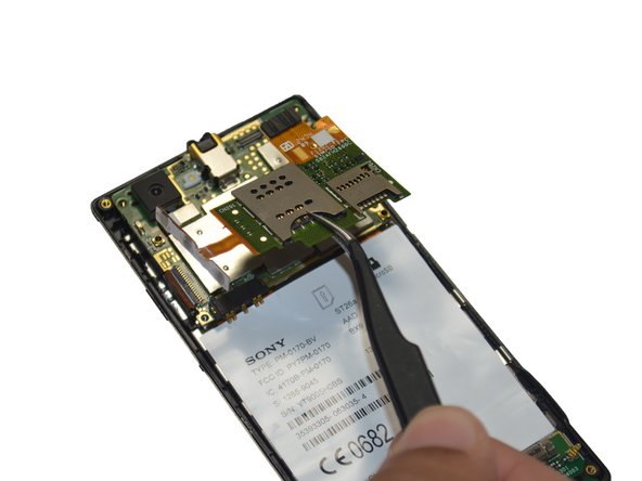

    1. Sony Xperia J SIM Card/Micro USB Reader Replacement, Removing parts: crwdns2935265:08crwdnd2935265:01crwdnd2935265:01crwdne2935265:0
      • Using the tweezers remove the clip located at the top of the phone. It should snap right off without too much pressure.
    2. Sony Xperia J SIM Card/Micro USB Reader Replacement: crwdns2935265:09crwdnd2935265:01crwdnd2935265:01crwdne2935265:0
      • Then remove the sticky pad located at the left of the phone using he tweezers.
    3. Sony Xperia J SIM Card/Micro USB Reader Replacement, Removing Parts: crwdns2935265:010crwdnd2935265:01crwdnd2935265:02crwdne2935265:0 Sony Xperia J SIM Card/Micro USB Reader Replacement, Removing Parts: crwdns2935265:010crwdnd2935265:02crwdnd2935265:02crwdne2935265:0
      • Using the tweezers lift the plate out of the clamps, from left to right.
      • Then remove the whole plate off the phone.
