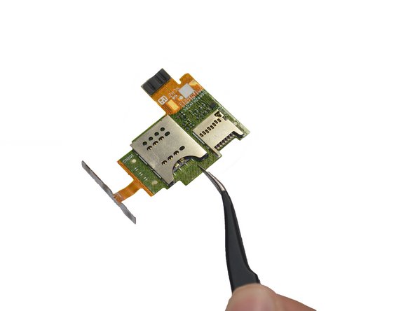

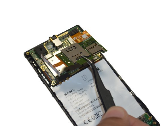

    3. Sony Xperia J Camera  Replacement, Removing Parts: crwdns2935265:010crwdnd2935265:01crwdnd2935265:03crwdne2935265:0 Sony Xperia J Camera  Replacement, Removing Parts: crwdns2935265:010crwdnd2935265:02crwdnd2935265:03crwdne2935265:0 Sony Xperia J Camera  Replacement, Removing Parts: crwdns2935265:010crwdnd2935265:03crwdnd2935265:03crwdne2935265:0
      • Using the tweezers lift the plate out of the clamps, from left to right.
      • Then remove the whole plate off the phone.
      • The plate might be a little sticky due to the glue used when assembling the phone.

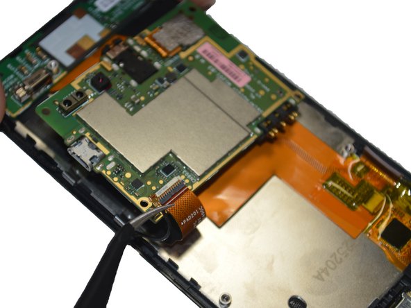

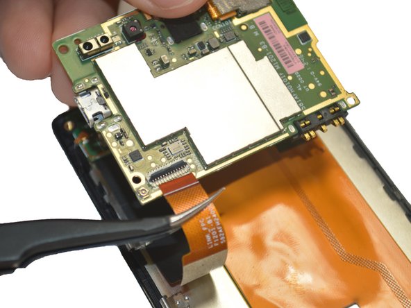

    5. Sony Xperia J Camera  Replacement, Removing Parts: crwdns2935265:012crwdnd2935265:01crwdnd2935265:03crwdne2935265:0 Sony Xperia J Camera  Replacement, Removing Parts: crwdns2935265:012crwdnd2935265:02crwdnd2935265:03crwdne2935265:0 Sony Xperia J Camera  Replacement, Removing Parts: crwdns2935265:012crwdnd2935265:03crwdnd2935265:03crwdne2935265:0
      • Once the sticker is off, unclip the clip on the top left side(below the camera). Then slide out the wide orange cable below the clip.
      • Then lift up the board carefully and remove the clip and cable on the back.

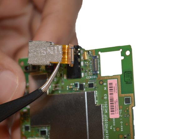

    6. Sony Xperia J Camera  Replacement, Removing the Camera: crwdns2935265:013crwdnd2935265:01crwdnd2935265:02crwdne2935265:0 Sony Xperia J Camera  Replacement, Removing the Camera: crwdns2935265:013crwdnd2935265:02crwdnd2935265:02crwdne2935265:0
      • Pop the camera out using your fingers, and then unclip it off the board using tweezers.
