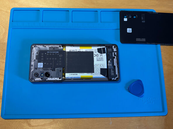

    • Replacing the screen on this mobile is quite involved. You have to detach the screen and also to open the backside to get to the connector.
  2. Sony Xperia 10 VI Screen Replacement, Remove Back Cover: crwdns2935265:02crwdnd2935265:01crwdnd2935265:01crwdne2935265:0
    • To remove the back cover, you have to do the usual: heating with a heat gun and then pry it open with opening picks.
