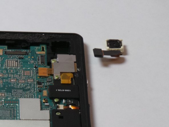

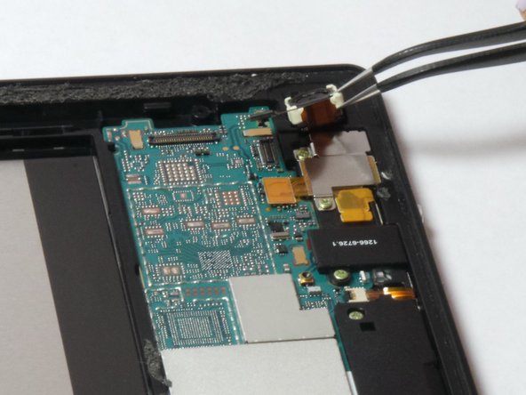

  3. Sony XPERIA Tablet Z Front and Rear Facing Cameras Replacement: crwdns2935265:03crwdnd2935265:01crwdnd2935265:03crwdne2935265:0 Sony XPERIA Tablet Z Front and Rear Facing Cameras Replacement: crwdns2935265:03crwdnd2935265:02crwdnd2935265:03crwdne2935265:0 Sony XPERIA Tablet Z Front and Rear Facing Cameras Replacement: crwdns2935265:03crwdnd2935265:03crwdnd2935265:03crwdne2935265:0
    • Disconnect the back camera from the port located in the upper right corner.
    • Lift up the camera cable using the tweezers.
    • Wiggle out camera from the slot.
