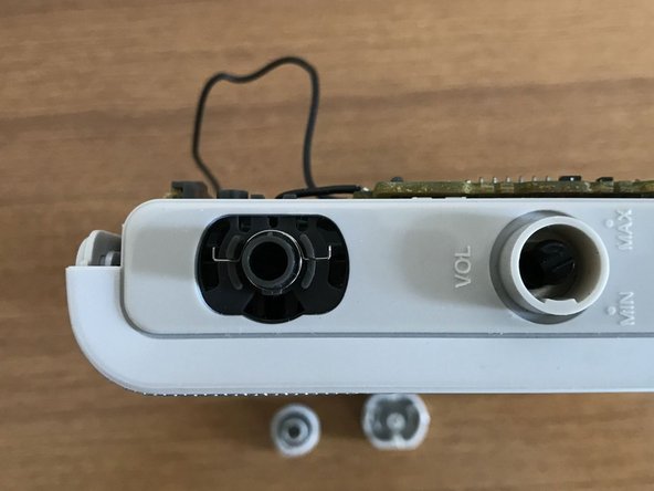

  3. Sony XDR-S50 DAB Radio Disassembly, Removing the knobs: crwdns2935265:03crwdnd2935265:01crwdnd2935265:02crwdne2935265:0 Sony XDR-S50 DAB Radio Disassembly, Removing the knobs: crwdns2935265:03crwdnd2935265:02crwdnd2935265:02crwdne2935265:0
    • Pull off the volume knob.
    • To remove the tuning knob, gently prise it off with a jimmy.
    • Under the tuning knob you will see a spring. Note its position for reassembly and remove it, taking care it doesn't take flight.
